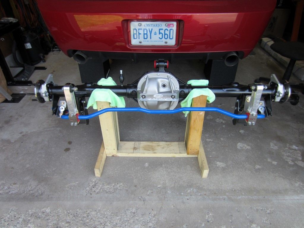

I went with 17x7 215/60R17 and 15x10's 325/50R15
Sway bar relocation brackets are easy to install.

Location: Usa
Posts: 1,388
What can u tell me about the 325 in the rear? Did u have to modify anything else other than the sway? How much are u lowered?

Posts: 357
Originally Posted by Rosariors3 View Post
Wow that looks awesome
Thanks!
Lots of mods to get them to fit like they are. In my first car picture the front splitter is sitting on the ground and the rear is being held up by the differential resting on the 3" over axle pipes. Car is bagged, differential shortened 1" per side, jounce bumper frame landing points have been removed and plates made for the differential to move the jounce bumpers under the frame rails.
This is what it looked like before the diff was narrowed on Steeda Sport springs.
From a couple years back, 325 are out side the fender line but with a 1.5" drop or so it really is not an issue.
