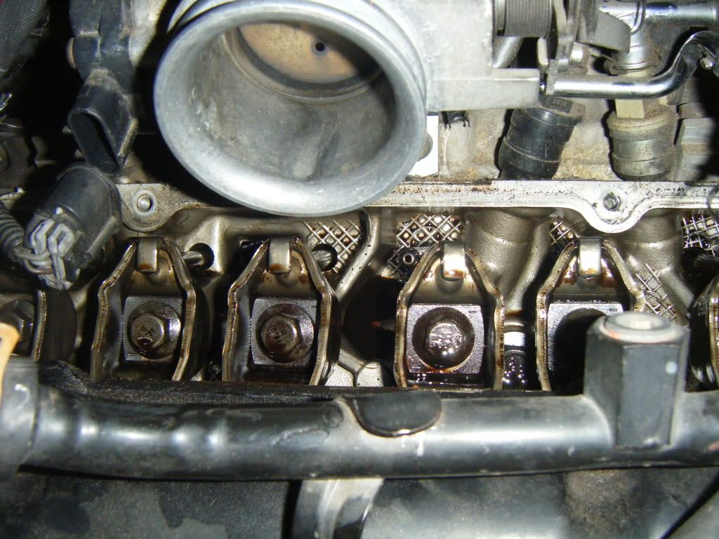

Re: Misfire on #5 code
@ SBrady9 Yea I typed a little much but I wanted to tell everything I did. I don't want to get the same solution over and over from everyone on something I have all ready done. It is just more eazy for me that way.@ Straublittleman You where right the rocker arm bolt had backed off on #2exh. Last time it was #3exh rocker. So I locktight it down and torqued to spec and did all the rest of them too,(#3 exh rocker was still tight so the locktight was working)Hopefuly this will never happen again. I drove the car around and no cel and no skipping,no nothing like it never happened.. I wish I could talk to who ever had this car and find out if thay had this problem or if there work was the problem.LOL Here is what I saw when I took off the valve cover...
Thank everyone for all your help!
