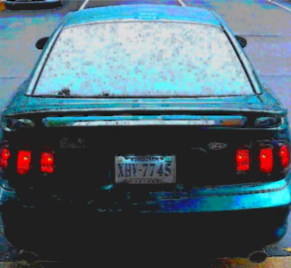

Lowered The Mustang
LOWERED MY MUSTANG:
ID:	31543   Click image for larger version

When I lowered the car I used these parts- -Took me over 10 hours to get it done being my first time at it:
-Ford Racing "B" Springs
-KYB Shocks/Struts
-Maximum Motorsports Caster Camber Plates
-Steeda X-2 Balljoints
-Maximum Motorsports Bumpsteer Kit

-It took me two years of researching and studying to decide how to put it together. At the same time I was purchasing the parts here and there when I could find them cheap. My biggest worry was that the V6 engine is about 100lbs lighter effecting the front end behavior and stance. Using the X-2 balljoints got me that extra 1/2" drop that made all the difference. And that 99% of all lowering springs are spec'ed for V8's.
The Ford springs and KYB shocks/struts I got for $100.00 at a Mustang meeting.
The X-2 balljoints i got on ebay for $120.00
The Caster Camber Plates were from Stangmods.com. I got the MM Bumpsteer Kit from them too. Both times, they e-mailed me a 15% Off discount code. So, I don't remember the total price but it was still real expensive.
I did soo many hours of research and saving files, placing a bunch of suspension pages on my favorites list. A lot of questions.
Agent47 was helpful, so was Maximum Motorsports.
Anyway, the ride now is so soft and comfortable. It absolutely did not get stiffer. Turning radius increased when parallel parking ect. High speed turns and cornering do not pull you and everything in your car to one side so much anymore.
Now that I am done, I have discovered a bunch of V6 specific lowering springs to choose from. Ford Racing has "F" plus a new one for V6's, Eibach has a V6 set, B&G has a set, Roush has a set which I read were just incredible performing and looking.
Well, it was a long *** wait but I am so happy now that it is done!

Thanks, These parts turned out working nicely. I love the smooth ride. Took a long time to pick up all the parts, took a long time to install, which made it all that much more satisfying when complete now.
A "Sticky" thread with postings of what parts were installed would be helpful for V6 owners. It wasn't easy trying to gather the best springs and shocks/struts to compensate the weight difference up front with a lighter V6 engine.

More than 2" front and back. You can see the Before And After Pics:
BEFORE:
AFTER:
-I did the job myself and then took it to get aligned at the specialty shop. It took me and my brother-n-law over 10 hours to get it done. I had never worked on suspension parts prior to doing this job.
