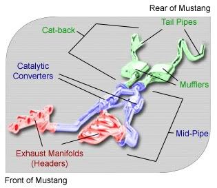

The "Y" is after the cats. I still have my cats. Give me a few and i will give you a detailed explanation with pictures of the whole thing before and after. I am at work right now but I'll take a break shortly and hook you up with some drawings that show it all and what to do-

Here is some quick reference material. The exhaust system is practicall the same for 94-04 Mustangs. When you are purchasing tail pipes & mid-pipes, you have to purchase your model generation though. Example 94-98GT, OR 99-04GT mid pipes and tailpipes are what you will get for your V6 (Depending on which year your car falls under).
Here is a write up on "HOW TO":
Installing a GT-takeoff dual exhaust system on a 99+ Mustang V6
---------- Post added at 05:00 AM ---------- Previous post was at 04:51 AM ----------
So, what you see is that you can cut out the "Y" pipe. Buy a "GT" cat back OR install a "mid pipe", then your choice of 2.5" offset mufflers, then lastly a set of "tailpipes". Just remember to get the correct year mid-pipe or tailpipe (94-98GT OR 99-04GT), they are sold under the GT parts section. Hope that helps!
---------- Post added at 05:21 AM ---------- Previous post was at 05:00 AM ----------
one last thing, I promise- A lot of people buy this kit and attach a GT catback to it. It fits on perfectly after you cut out the "Y" pipe- FYI:
