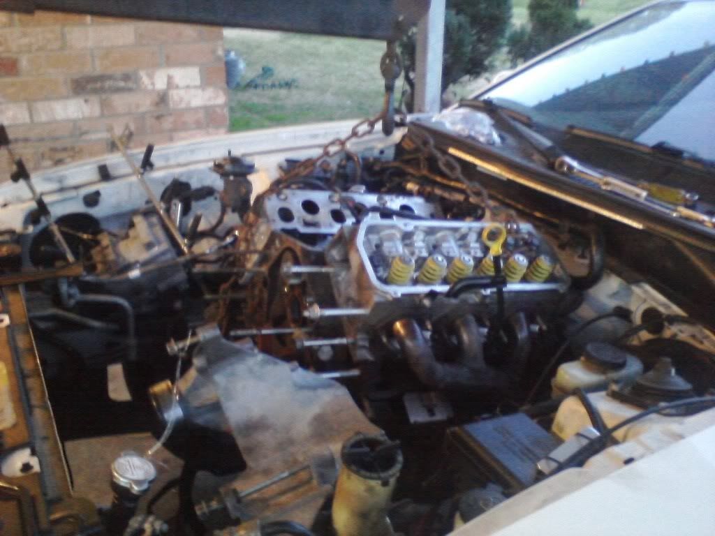

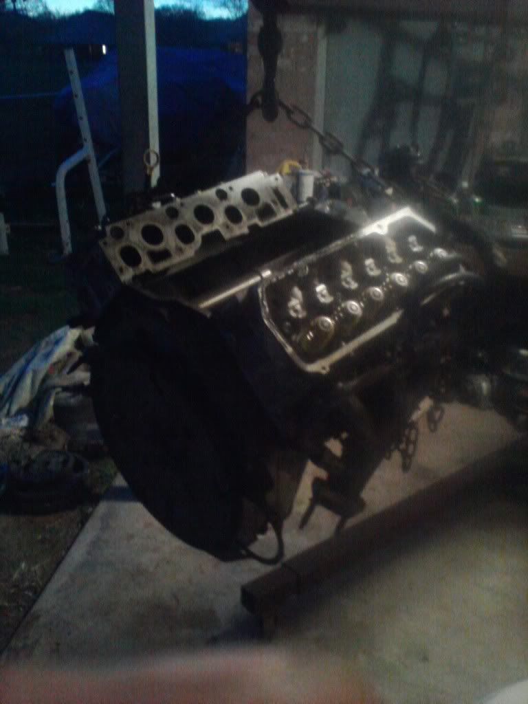

Old 01-09-2012, 09:32 PM   #14
Evolution's Avatar
Posts: 414
Oh ok, yea I'm just about there, not too much more.

Old 01-09-2012, 09:45 PM   #15
Posts: 177
Re: Gasket blown
OMG thankfully I decided to play with my split port and not a single port. What a cluster **** those things are lol
SenorMike is offline   Reply With Quote

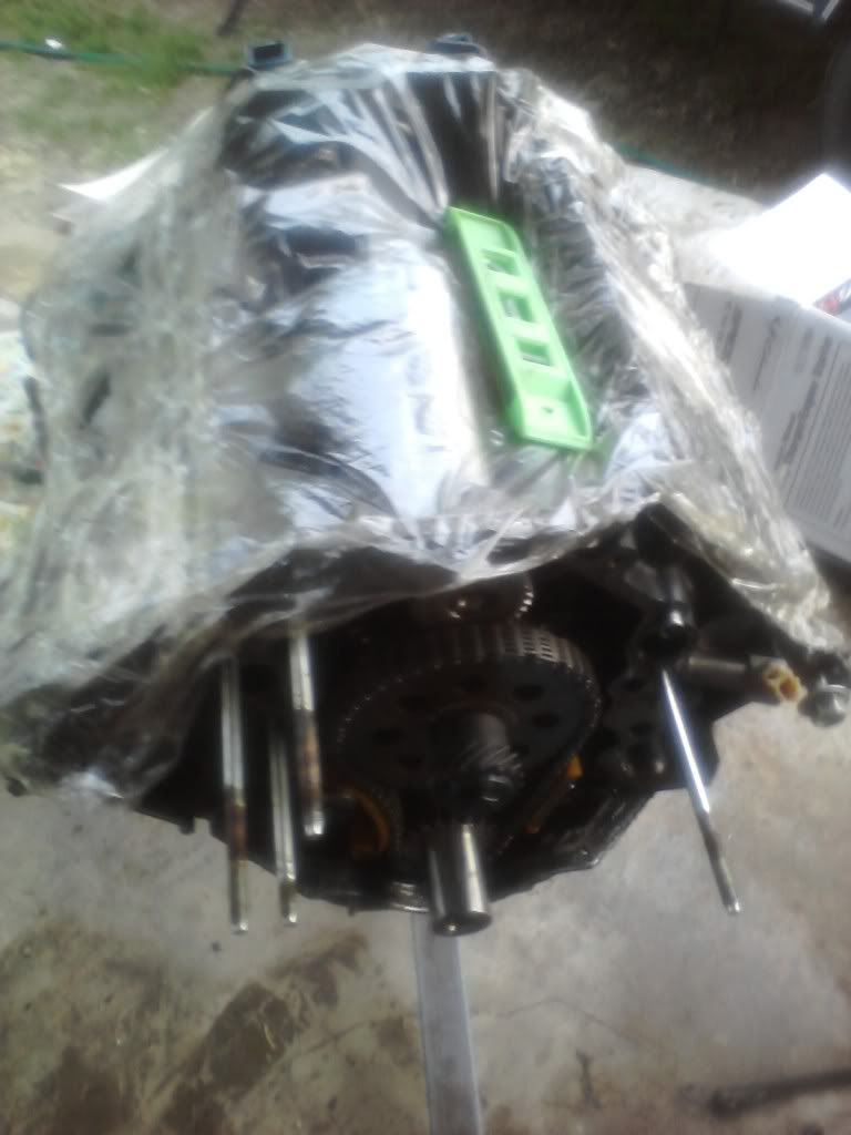

Old 01-11-2012, 09:49 PM   #18
Evolution's Avatar
Posts: 414
Ok almost there! Having problems getting the far bolt on the drivers side on holding the head. And all of my bolts holding the head from the top were all unevenly tightened.... Anyways here are some pics!

Old 01-12-2012, 09:09 AM   #20
Posts: 177
Re: Gasket blown
tty bolts "stretch" so im sure thats part of your problem, unless someone has redone those ... lol
Their is a specific way to do them and I just want you to know its going to be a huge PITA when you go to install the heads with that brake booster in the way ...
Id look into pulling that or pulling the whole motor lol.
Im in the middle of the same project, bought stall while its out so im waiting on that before I put the motor back in, but anyways, I just pulled the whole damn motor just to do the gaskets

Originally Posted by SenorMike
you'll want the entire engine from a super coupe to swap on. Stock mustang heads aren't so great w/ the m90. And you'd have to drop the boost I think w/ a weak sauce mustang block lol
Mehhh maybe -_-
WTF kind of head gasket was used there ?
Ohh and you are officially the first person Ive ever seen post a picture of heads off a car and the spark plug still be in them lol
So you would suggest no supercharger?
Ha thats funny, i didn't know you had to take em out, looked easier to leave them in.
