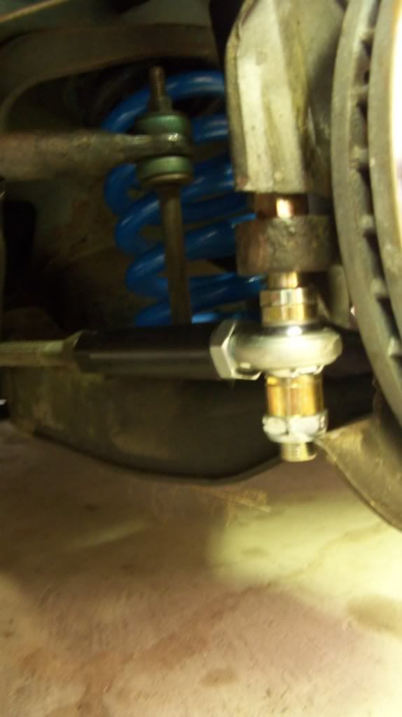

FYI- I have longtube headers too-
This is what mine looks like.
FRPP "B" springs no iso's, KYB struts/shocks, MM C/C plates, MM bumpsteer kit, Steeda X2 balljoints:

It's at least a 2" drop. Because our engine is 100lbs lighter than the V8, I put on the X2 balljoints which give you some additional lowering up front. The springs, shocks & struts are Fox Body. An inch or two shorter than stock. It all turned out great. The ride is so comfortable and the handling is phenomenal, turning, bumps while turning, braking without nose dive, ect.. I love it. Ford Racing "F" springs are specifically made for our V6 cars. I have a complete list of all the manufacturers who make lowering springs for our cars and their spring rates somewhere, if you ever need it.
Some pics of my 10 hour install (first timer):

X2 BALLJOINT:
Designed For Optimum Handling. Steeda's X2 Ball Joint will greatly improve the suspension geometry on your lowered Mustang by raising the spindle relative to the pivot-point of the ball joint. This raises the roll center back into the correct range, resulting in reduced body roll, quicker steering response and improved overall front tire grip.
Tested In Extreme Conditions. The X2 ball joints are made in the USA to Steeda's strict specifications by a respected name-brand supplier to Ford, GM, and Chrysler. Except for their unique custom length, these ball joints are constructed from the the same OEM materials that have been extensively tested in Ford police cars and other heavy duty service vehicles, where they have far exceeded the durability of current production "stock" ball joints.
Eliminates Body Roll. The X2 ball joint was specifically designed to correct the front roll center geometry. The X2 ball joint features a longer shaft, to raise the spindle in relation to the ball joint pivot point. Springs spacers are included in the X2 kit to maintain the same ride height as the stock factory ball joint, but with an improved roll center height.
