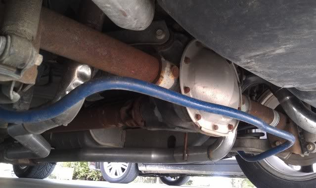

here's mine btw...i gave it a coat of engine enamel just to seal it off from the elements...i mean why not right lol

looks good man. thanks for the help. im going to take a trip over tho the scrap yards and purchase one. but on the fronts do you know which size was the largest? like what years?
