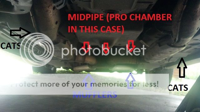

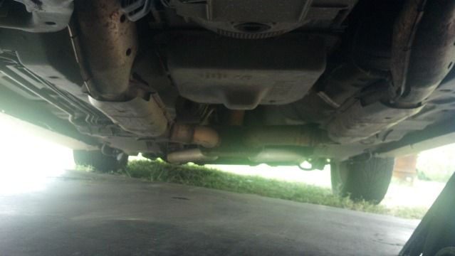

there's three types of dual setups our cars run...a Y pipe setup that is cheaper to run but more restrictive and quieter...a divorced setup with means from each manifold to the tailpipes is it's own tube not connecting to the other side in any way...and finally a setup running a midpipe (i.e. x, h, or PC) which means the two tubes from each manifold is now connected in the center
ok so right now this is my current setup...stock cats...mac procamber...and 2.5" mandrel bent tubing out the back
(not the prettiest tubing from the cats to the PC but i had to have it fabbed because it was used before i bought it)

Old 09-02-2012, 09:20 PM   #17

Is that an h pipe in the picture there? And thanks for all the info its all starting to make more sense now!

To build on this
if i ran mufflers that would be a perfect diagram lol
Originally Posted by Ritter View Post
In your opinion will the divorced sound undesireable?
not at all..i ran divorced on my last v6 for years.
Alright! Ill look into them! The only problem is, are they technically called divorced pipes? Cause i cant find them as oppose to h pipes on summitracing.com
Also re-asking are these the dynomax thrush mufflers that were suggested earlier? Cause theyre only $26 - http://m.summitracing.com/parts/wlk-17702
Ritter is offline   Reply With Quote
lol, well we'll pretend there are some there to fulfill the learning experience
