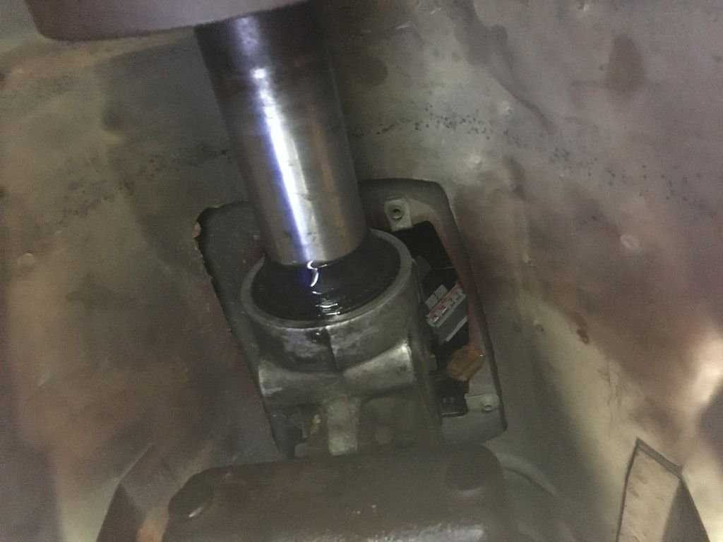

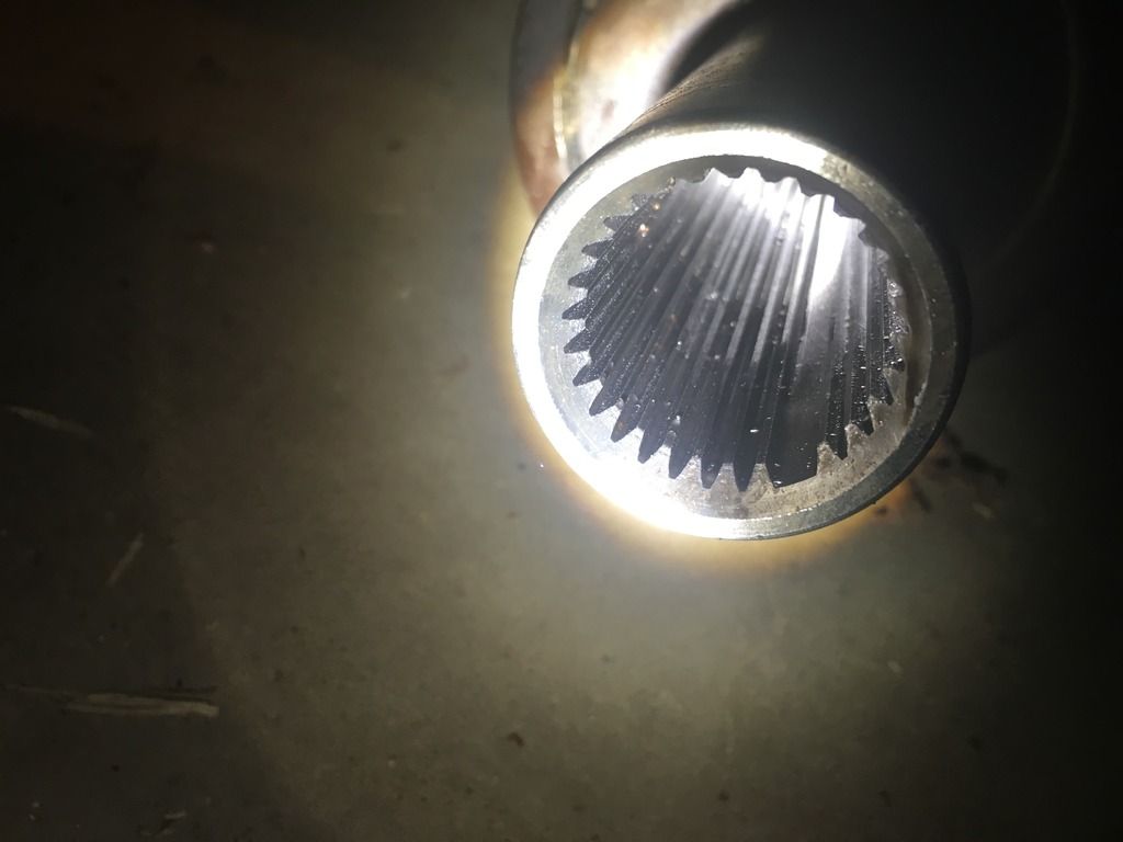

Hey guys I got everything put together except the driveshaft yoke is not sliding in the transmission like it should, it goes in about a inch or two then stops. Any suggestions ? Should I buy a new one and hope it's not the transmission side ? [IMG][/IMG]
[IMG][/IMG]
Aaron_2014 is offline   Reply With Quote
