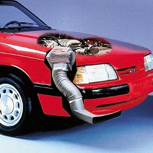

Has anyone heard anything about or used the March 1410 ram air system? I wonder how well it would work compared to a fenderwell mounted cai.

I have it installed on my daughter's 89 GT Convertible it works fine and since it is picking up pressurized air from the front of the car it probably works better because the air is being forced in when at speed.

Cool, in the picture it looks really good hooked up to the lx but I feel like the saleen front bumper would block that air.

It goes under the bumper.

Cool, how does it bolt on?

I have it, removed the under bumper air inlet though. Really low on my GT and when it rains the roads flood around here. I'd actually like to trade it for a fenderwell kit but lost the inlet.
Yeah, that could be a problem.
My daughter's car doesn't get driven in the rain, so it's safe.
I do however intend to do something similar on my 86 GT, but I intend to use the fog light hole for the air intake.

Had mine hooked up like that for a little bit except I used both fog holes. Guess you could mount it in the middle opening as well to gain some clearance.

Darn, yeah i didn't even think about that. Don't really drive around in the rain too much but that wouldn't be good getting water sucked all the way up there if I have to drive to work. I think I'm just going to stick with the fenderwell.

Fenderwell mounted air filters can get wet in the rain too.
Take a look in there after driving in the rain.
The March filter is located up in the box under the hood and they may already have one, but you could also cut a small drain hole in the bottom to drain any excess water without losing much of the ram air effect.

Ahhhh drilling a drain hole is pretty clever. Thanks man I'll reconsider my reconsideration.

I did a search on issues with the March Ram Air and some people had issues and others did not.
One guy had been running his for 13-14 years with no problems.
I noticed that the guys who had problems, most had those problems during heavy flooding rains.
If you drive it fast enough into large puddles or flooded streets I'm sure you could force enough water in there to damage your engine.
A little care and some common sense will keep you safe if it is what you really want to use.

The kit is nice... I only pointed out the rain factor because where I live if it rains hard for any amount of time the streets flood. I drove it in the rain for quite some time, wasn't until a 2003 Cobra with a low mounted fenderwell kit came in the shop that I took mine off.
People with regular cold airs lock there motors up trying to drive through a couple feet of water around here..lol

Here too, and the most common statement when they've killed their engine is: "Oh, I never thought about that."
Most people are not mechanically inclined, so they don't think like a lot of us do and they are not aware of certain consequences of their actions, so they will blindly drive right through large puddles and flooded streets.
