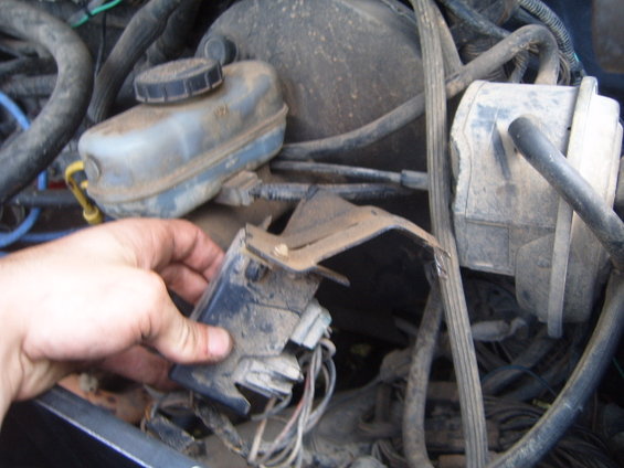

but anyways, i never worried about the bracket for the factory airbox with the FIPK in it cause it fit perfect in there, so i will have to modify it
I am gonna get my angle grinder back from my dad and cut most of it out, but leave enough for the winshield washer resevoir to stay in location, and relocate the connector thingy mebob that is attached to the bracket
if i dont, the new air box will look like this in there

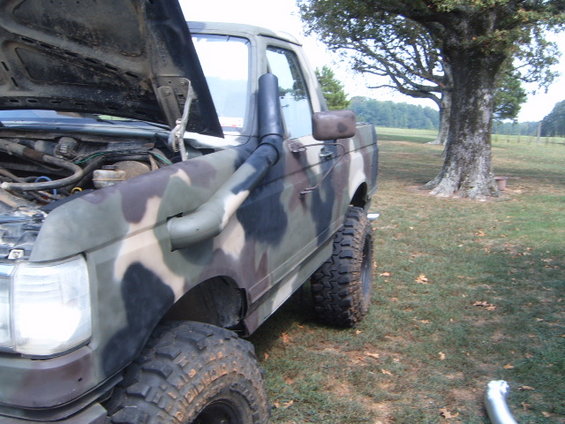

Posts: 3,263
Re: Tex's Snorkel work
Pretty cool man. I assume your gonna run it across the fender and up the A-pillar like most trucks?
yeah, it will exit about mid fender at the top then run up the a-pillar. just gotta figure out a way to secure it to the body. thinking large clamps that you run a bolt through, hard to explain, but there are a ton on C-130s (probably where i would get htem from too) but im not so sure how well it will hold up like that, to loose if you know what i mean.
I was origionally thinking of running it through the firewall, but it being a 5.8l EFI engine, too much crap on the drivers side firewall, and i cant think of a good way of turning it the other direction without a ton of new hoses and ****

ok here is todays work on the rig
air box now fits in the rig
had to take the factory airbox/washer fluid resivoir out though
till i find a suitable place to relocate this, i just cut that chunk of the bracket off
cutting into the sheetmetal again, everyone said after i cut my fenders it wouldnt be hard to lose more sheetmetal, still pained me to make this cut
should have bought a bigger hole saw, after an hour of fawking with it, i just couldnt make the 3" hole work, kinda like trying to stick the square into a circle type thing, they just dont fit
my work area, notice the dryer vent, yeah that failed miserably
so instead of coming out of the fender with the dryer vent into a the pvc, i used my 90* bend that was for the top of the snorkel thier instead, now yet again i gotta go to lowes
bottom portion painted up
test fitting the top portion
from inside the cab, not much blockage worth really mentioning
does not intefere with the door operation
under the hood
all painted up and mounted
doesnt stick out very far (notice the condisation in the blinker, oct 04 is when i sank the damn truck, i think i need to take the lense off sometime and dry it out

after extending the pvc from the snorkel to the air box and cutting a bit more off the last remenants of the air box bracket
for the most part done, gotta figure a way to mount the washer fluid/coolant resevoir since i cut its bracket off, dont want to use 300 zip ties to hold it on, silcone things up, get a dizzy boot, and really thats it.
