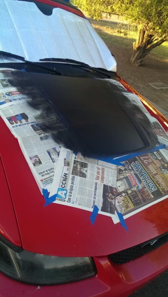

This was a fail

This was a fail
How is it a fail beside the lil bit of over spray on the newspaper lol, seems like it look good to me

I start to spray on the newspaper and work my way to the other end. It came out good but when it came time to take the tape off it all went downhill. I'll try again another day

This was a fail
It's hard to plastidip taped off surfaces . The trick is to give the center a few coats and let them dry then hit the boarder on the tape and immediately remove the tape before it dryers

I never thought about that. I'll do the middle first then the edges. Thanks
a fresh razor blade and a steady hand works too. Hold the blade, keep your arm stiff and just move your body. *Straight Lines*

Will I scratch the paint? This isn't my first time with plasti dip but it was my first time doing it alone

Only press hard enough to score the coating away from the edge of the tape. Go slow. its only a small area. use a lot of light.

Wouldnt use a blade....i tried and screwed up lol.
Just before you peel off the tape add one last coat and peel off tape while its still wet that way the tape doesnt lift the plasti dip off
Just peel it as soon as u lay the last coat down & it's still wet! The tape will come right off & make a nice line. What I did was just lay all the plasti dip at one & then peeled the tape I didn't let it try between coats u just have to be carful to lay it down evenly so it won't drip!

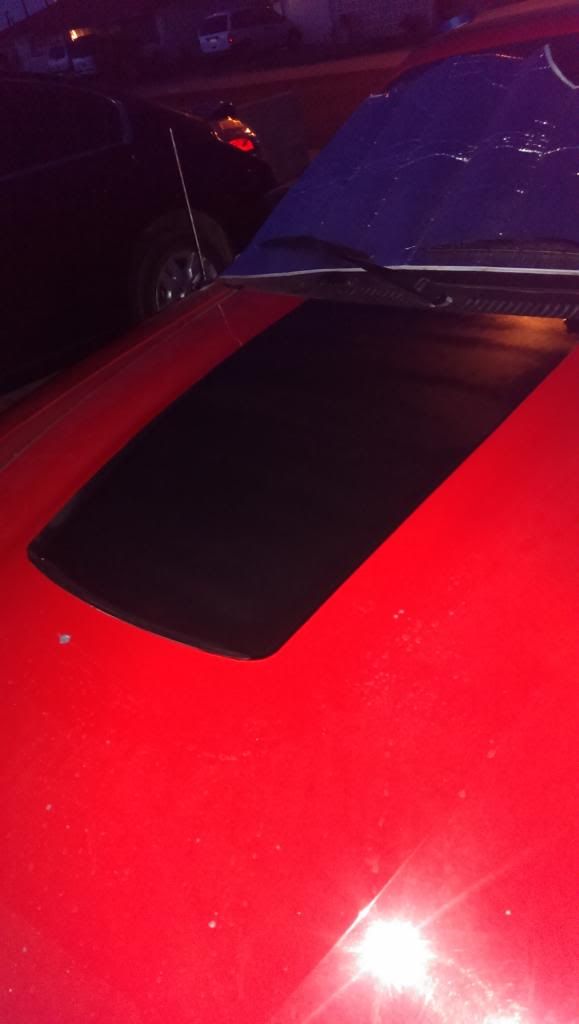

Sprayed the last coat by the tape but I can still see red and I used the whole can
Looks good from the pic

Thanks I hope it looks good in the sun. My cheap A$$ can't afford the decal
Looks good bro!!
