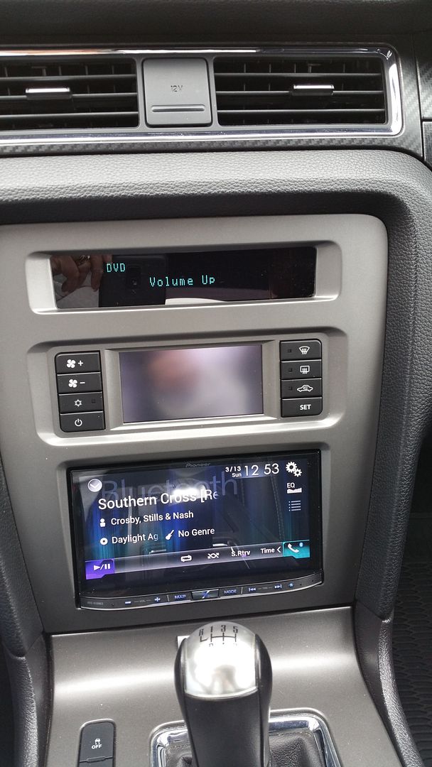

I do have a vert. I haven't had any problems with the alerts (she shouts - I am shutting her down (on you are speeding) The turn instructions are way loud too - I have to adjust the volume down on that as well. The mic is where the synch mic was up by the lights above the rearview mirror and my husband says he heres weird glugging noise when we are talking- like I am underwater - but only every now and again. Not sure what to do about that - get a better mic - or try to have it moved. One of the wiring harnesses for the steering column buttons was bad and we are replacing it - Bought a Scosche install kit and for some reason the climate controls are screwed up. The installer talked with them and he has to do a firmware reboot sort of thing to it and it should take care of the problem. So when the part comes tomorrow - we take her back and he'll put in the new wiring harness and the reboot and all should be good. I like the back-up camera. The Pioneer allowed us to erase the lines it came with and put in lines that make more sense. 1 foot and 3 foot. It is nice to see what is behind you and a wide view as well. Best thing I did and it doesn't look crappy on the back of the vehicle - you hardly notice it above the middle of the license plate.
My car is loud and my husband says it comes quite clear thru the phone mic when we talk -he can hear the rumble and the shifting. LOL. But so nice to be able to talk without an earpiece. My phone for whatever reason was having a hard problem synching using the Ford synch. This is much better. I haven't tried out the Android Auto yet - but he gave me a demo on his truck before we installed my equipment and it is pretty cool - to have the google maps as well and all the streaming music (all though you can do that thru bluetooth by just turning it on your phone and setting it to bluetooth. I also have Sirius - I have to switch it over to the new radio yet - waiting till all is finished . Installer did a great professional job and was only 300 dollars. Can't tell it didn't come from the factory the way it is. It sounds great with the Shaker sound system - and I've been warned not to play it too loud - it could easily blow out the speakers LOL.
I had turned the car off but hadn't gotten out yet, so you don't see the climate controls in the window in the middle - I replaced the nasty screen on top with a piece of acrylic pre-tinted plexiglass. It attracts dust but doesn't scratch or smudge like the other piece - it shows the outside temp and the direction and if I use the buttons on the steering wheel it will show the last one. After you have left the car and come back and start up - it shows temp, direction and DVD. But I am ok with that. I will let you know more after everything is working and I've had a chance to play with it. So far I am very happy with it. Will be ecstatic when all works. The reason I have the extra climate control buttons on the kit rather than just screen - if the pioneer should go bad for some reason I still have climate control - I thought that was a very nice idea on the part of the installer.

We can't get the air flow to work right consistantly - move it from defrost to front to feet. The circulate air within the car doesn't work at all (the button doesn't light up) and the same with the rear window defrost- isn't working at all and not lighting up. The fan can stick at one speed. Just glichy type stuff. According to Scosche they said he needs to do a firmware update and that should solve the problem - I don't know if that means the second usb harness. And we are getting a new harness that will make 3 buttons on the steering wheel work. PAC RP4-FD11 Wiring Interface is the part that needs replacing.
I may mention to our installer about the second USB Update Harness needs to be plugged in properly....

I made the mistake of only plugging in the factory hvac harness, I left out the usb firmware harness, it caused all sorts of issues, if I tried using either defrost button, it locked up the Scosche climate controls

I told that to my installer and sure enough that and a firmware update was the problem - the climate works great now. Only problem is still the synch buttons on the steering wheel won't work. He has tried another part tried resisters etc - got the buttons to work but not the other 5 that were working. He has an idea he is going to try tonight. Otherwise I may have to either buy something to maintain the synch buttons (will not leave the car in a position where they don't work in case of resale) or we will put it back to stock - here's praying that (going back to stock) is not the final decision!

Yes I did! - it's free. You pay 69.99 and get a Visa Card for 70 bucks. The sound of the stereo is amazing too. I figured out how to get the lady that literally shouted at you that you were speeding to shut up - now I just get an image (if I am paying attention) and found the volume controls for the turn by turn instructions and turned them down -they about broke your eardrums. I can answer the phone from my steering control but to make a phone call I do have to hit a button on the head unit - after that it is all hands free. I can mute the radio from the steering wheel as well. He did a great job. Tried the heated seats this morning - its is 28 right now and they worked great as did the heat. The manual is over 200 pages of information - unreal. I am a happy camper. Love the look - just wish the head unit was higher is all - but I can live with it down where it is.
Before and after shots
So much to learn - this unit is amazing what it can do and I haven't even started with Android Play yet.

awesome! looks amazing

He did a great install job. Looks factory. We are happy! Your mix between 2 sets with the headunit up higher would be the better install but.....this ain't bad at all. So much is voice controlled that being lower like that doesn't really bother us - unless we are looking at the map....but you get used to that too.
