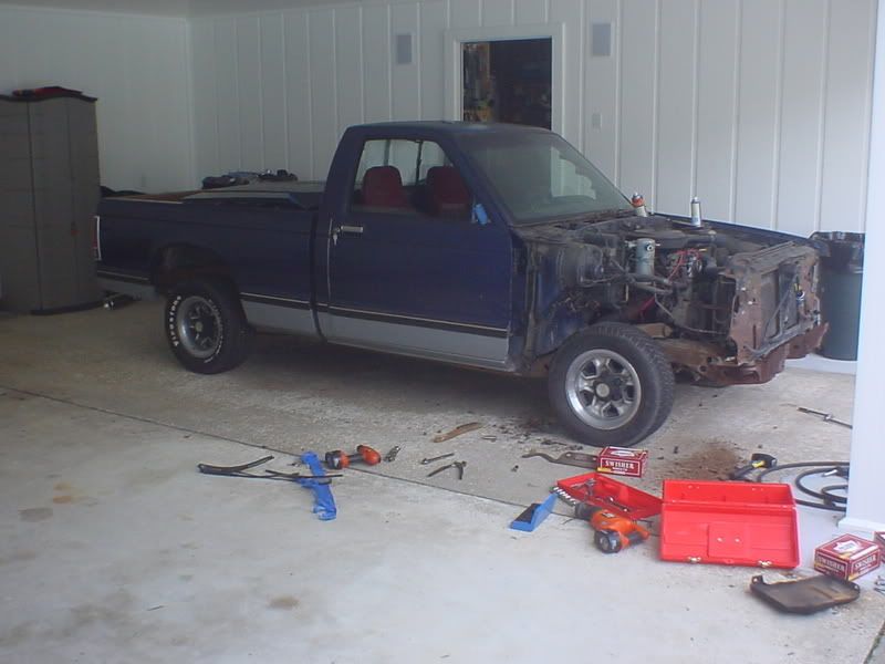

just thought i would show yall the progress i have gotten on it...
*just to let you know, i have gotten roller rockers since getting the cam set-up that i have.
... and motor spec:
Motor is a crate shortblock with
- vortech heads
- comp cams 274/286 hydraulic roller cam
- comp cams chromoly push rods
- comp cams cam-matched timing set
- comp cams cam-matched dual-spring set-up
- stock hydraulic lifters
- screw in studs
- guide plates
- 3-angle valve job
- decked/milled
- bigger spring seats cut
- MSD Pro-billett HEI distributor (fire-wall beating, oh yes, but worth it)
- Headmen Headers
- Camaro drive plate, and starter
- Power Plus Crosswind dual plane intake
- Holley 700cfm Double pumper Carb.
- Crinkle Black GM Dress up kit.
- RCI 12 gallon fuel cell with foam and sending unit (that i had to put in)
- Holley Blue Fuel pump with 3/8npt brass barb fittings and Blue pushloc hose
BlownAMC is offline   Reply With Quote

woohoo! it's in! radiator clearance is great, HEI distributor clearance is great... just waiting for my headers to come in as well as transmission, to test the driveshaft. I'd rather cut the driveshaft to fit than to beat the firewall or anything like that.
I used the radiator from a 1986 Chevy Corevette, it has 1" cooling holes rather than three smaller holes, and it is aluminum, as well as being 140 bucks from work with a lifetime warranty. It should have no problem running cool.
It is mounted in the forward section of the core support where the a/c condensor would be, i think if i would have tried to go with a/c i would have ran short on space.
take a look...
