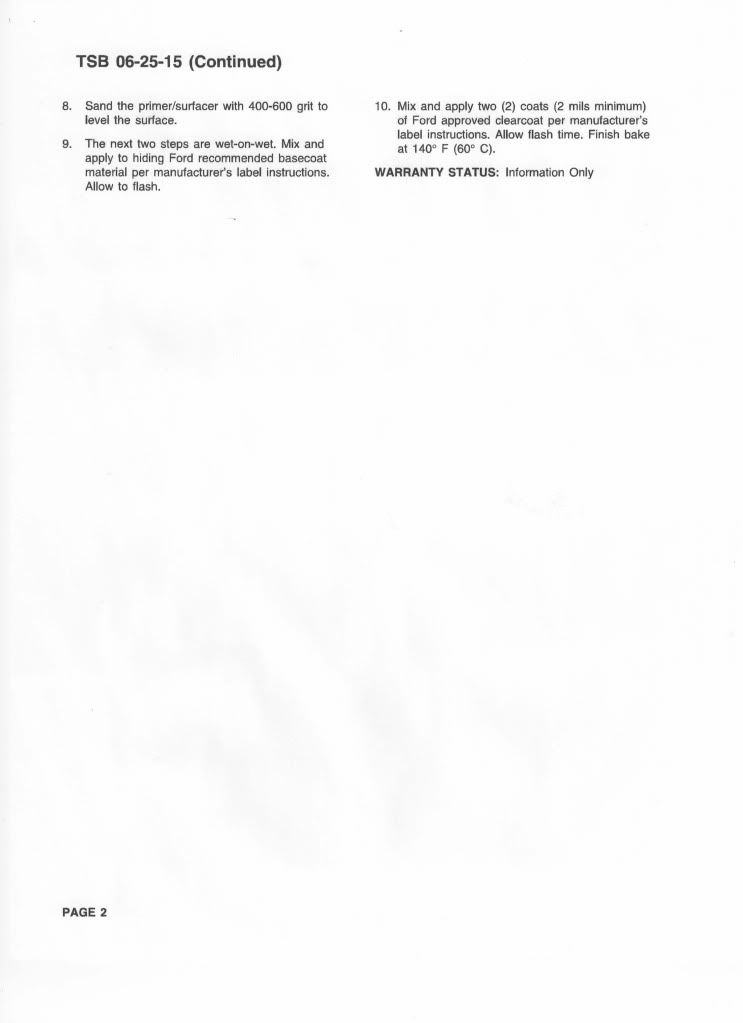

Old 12-10-2010, 07:50 AM   #15
st577's Avatar
Posts: 10
Re: Factory paint bubbling up ?
for FYI Ford service bulletin.
[IMG][/IMG]
[IMG][/IMG]
st577 is offline   Reply With Quote
