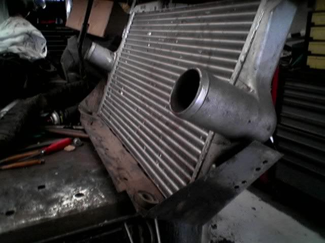

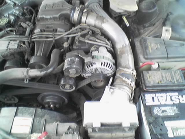

Yeah, an 1989 Ford Thunderbird Super Coupe. 3.8 super charged engine. I've had it since 1990. I'm trying to finish up a Ford SuperDuty Diesel intercooler conversion i just fabricated into my cars front end. Keep in mind, all this while keeping its factory intercooler bolt on set up as well. Pretty slick if you ask me. I got some cheesy phone pics i'll post up from photobucket.

Stock set up.
Modifing stock radiator support to hold cooler support.
First test fit.
