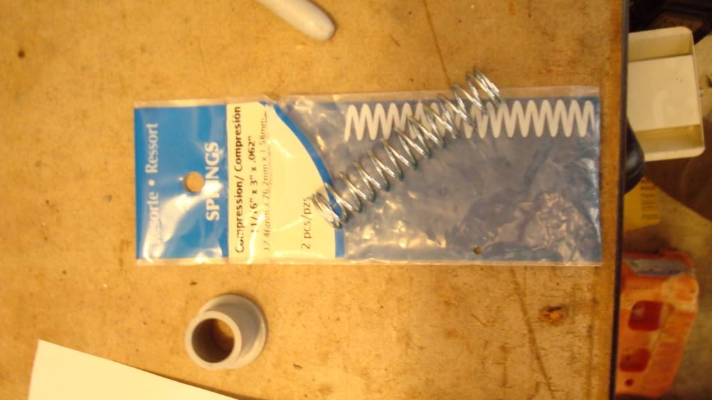

What you'll need:
These are Lowe's part numbers, you can probably find similar products at any home improvement store.
-246632 PB Spring Comp #47 $3.49
(the spring shown and the package for the spring)
-115970 1/2-3/4" PVC Male-Female adapter $0.72
(the small round pieces at the bottom of this picture)
The spring only comes as a set of two, so realistically for another 72 cents you will have two complete kits.

Pull the clutch dust shield off the transmission and detach the clutch cable from the clutch fork.
Slide the adapter piece over the end of the clutch cable with the smaller hole towards the back of the car (this is what the spring will sit on).
You will need to modify the spring slightly to make it fit over the clutch cable. I used a pair of needle nose pliers and pried each end of the spring outward slightly a few times to get the proper clearance. Once you have enough clearance slide the spring over the end of the clutch cable and set it against the adapter piece.
Now comes the tricky part. While holding the spring away from the end slide the clutch cable back into the clutch fork and let the spring rest against the clutch fork.
Your setup should now look like this:
Now crank the vehicle and with it idling in neutral with the clutch released climb back under the vehicle and check for the throw out bearing spinning against the pressure plate. Using your firewall adjuster get the bearing to sit slightly off the pressure plate, the spring will allow you to adjust it slightly closer without the bearing sitting against the pressure plate.
Once you have it adjusted put the dust shield back over the transmission and set the car back on the ground and enjoy your newly adjusted clutch.

Did you have an issue with the spring slipping into the pvc reducer? I picked up those parts today and the hole on the reducer is just a 1-2mm smaller than the spring but spring has elasticity so if I press on it hard enough with my fingers it falls into the hole. I think I might still use it but maybe see if I can find a washer to reduce the hole a little more so the spring doesn't slip inside.
It acted like it would be an issue...but never slipped on mine.
If you find a better part please post up, just someone trying to find a more affordable option.

Went to home depot today and found something:
This is the piece here:
Carlon 1/2 in. PVC Conduit Box Adapter - E996DR-CTN at The Home Depot
The spring doesn't slip into this one like the other one and it even looks a little like the piece that comes with the Chicago LDC kit. I had an old cable laying in the garage that I test fitted it on and it seems like it'll work perfectly.
pumm3l is offline   Reply With Quote
Old 10-19-2010, 08:46 PM   #15
Re: How to make your own clutch freeplay kit
I tried that exact piece but couldn't get it to sit flush how I wanted...

Finally had some time to put this in, it was odd though. I actually had to use 2 of those pvc adapters (the new adapters that I found at home depot) on mine- one on each side of the spring. For some reason the space from the clutch fork and hole in the trans for the cable is larger than yours. Even with 2 of those pvc fittings in mine it doesn't push the fork that much, I could probably stick a couple washers in there to add some more resistance.
I think the fingers on my pressure plate stick out further than other pressure plates which is why need that extra slack on my cable so it doesn't sit on the pressure plate. I have a UPR double lock firewall adjuster, maximum motorsports quadrant and a RAM powergrip clutch/pressure plate. This is also on a 99 GT with a t45 for point of reference. I thought maybe I had something installed wrong but the car shifts fine so I don't think it's that, I can't explain the extra space other than the pressure plate fingers sticking out further.
Oh and I didn't have to dremel the piece down either it cleared that little lip on the c-clip easily for me.
