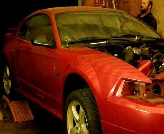

You sure can. But you would loose a lot of compression because the 4v head has a combustion chamber of 52cc where as the 2v has 42cc (if memory serves me). Now if you where to make a high boost machine (after you change internals of course) then the 4v heads would work. But there is a lot involved in 4v heads then just slapping them on. Let me get you a break down of parts. From what I have serched and found.
Tumble port heads - I got mine from LKQ for 115 w/o cams from a 00 continental.
Timing set- fms 450.00 comes with everything even new fasteners
4v oil pump - 80.00 for a good one.
Source a heater pipe from a Mach 1 0.00?
Intake 560.00 complete on ebay (tb, injectors, sensors,etc)
Basically the list gets bigger. If 4v is in your future then look for a complete motor. Because as I said the bill gets high.
Now myself I went the Mark route. Forged the internals and built it from the ground up.

A 4.6L is a 4.6L it fits. Everything it the same, and is a drop in.
From take out to install. The headers pictured were removed as the are ment to be installed from under.

I feel that I'm pretty sold on the teskid idea if everything swaps over completely!!
And we made progress! Taken all the waves out of the body as well as fixing the damage it had. The front was messed up. It had so many rock chips!! Also fixed the rear bumper damage but no pics of that. :3
