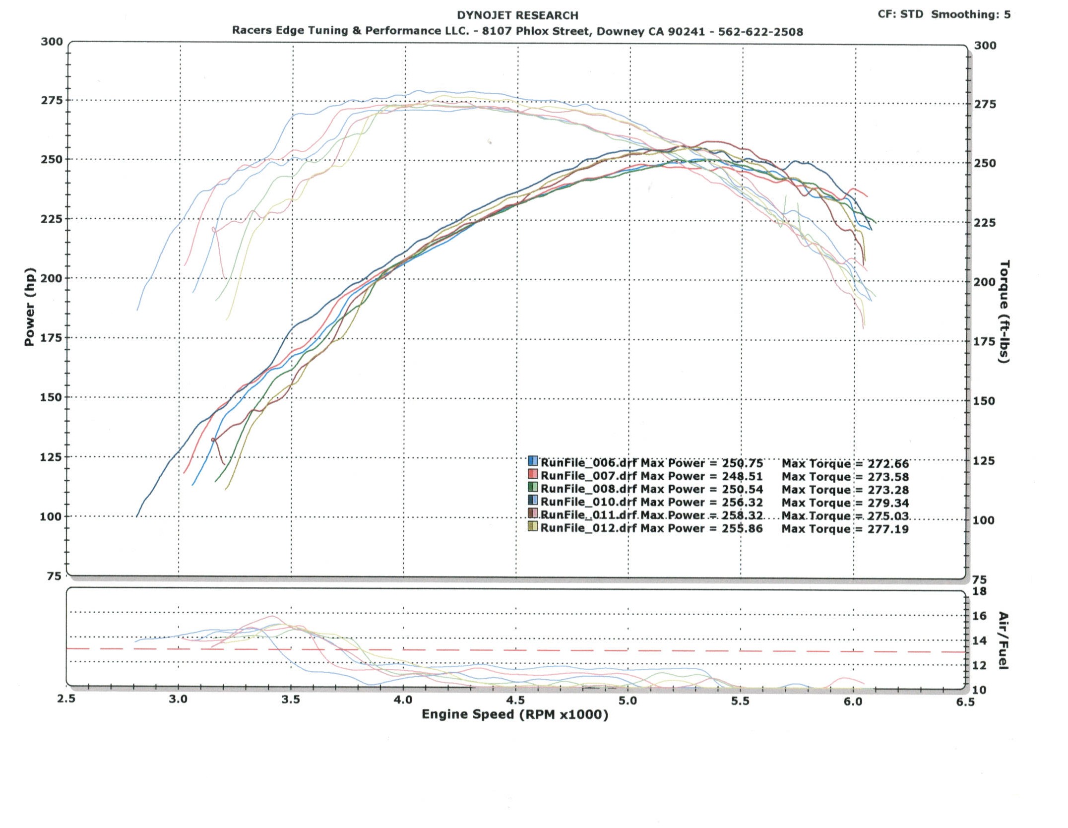

There are videos on the internet showing a 5-6hp increase from Dorman to the ford racing manifold. Not enough to matter for a daily driver really, save your money.

Plz reference said videos.
first 3 pulls are with the Dorman
last 3 pulls are with the ford racing intake

Posts: 17,005
Fom that chart I'm seeing up to a 10rwhp gain over the Dorman from an auto car with no other changes (248-258 both on the second runs respectively). PI intake is $50-$60 more than the Dorman brand new. If you don't think 10rwhp for $50 is worth it for a bolt on 2V you are nucking futs.
Even if we are talking about replacing a Dorman one has already spent money on, $215 for 10rwhp that you can do in an evening is still very worth it.
Old 08-08-2014, 11:06 AM   #25
Location: Parniak
Posts: 618
1. First Run - Gains 5.57 HP and 6.68 tq
2. Second - Gains 9.81 and 1.45 tq
3. Third Run - Gains 5.32 HP and 3.91 tq
Not sure of the math or dynos or averages but I don't see an easy 10rwhp gain from this. IF your building your car up then of course it is worth the time and money hands down not arguing that at all! If you already have a dorman and your car is a dd you shouldn't loose sleep. Your not loosing 20 hp and 20 tq as I have read on this site.
But as Scotty says for $50-$60 more than the Dorman you could have the proper intake. And would kind of be stupid to cheap out when doing the replacement since we all know at some point we had to or will have to replace the crappy stock one that IS going to crack
