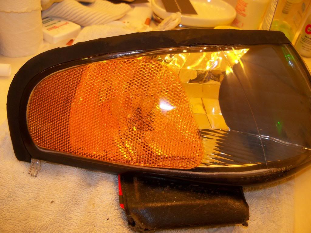

I have purchased Raxium, DEPO, Black Beauties (2 different manufactures), and the "Euro" black set.
**All cheap, all leak, all have rubber trim come off, poor light output. I take great care and time sealing them before installation, but rarely lasts 1 year+ before fogging up. Best output I have had is using Cobra style smoked headights with 4300K HID. Don't recommend HID's, they are illegal and blinding unless lens is smoked.

My DEPO projectors are awesome, no issues there and the wiring harness they came with was top notch. No leaks, no fogging, the 4300K HIDs in them are silly bright but there is no scatter at all. Granted, the beam does "rainbow" down at the ends and I am kicking around putting HIR halogens in the lo-beams in addition to the ones already in the hi-beams. A HIR 9011 or 9012 is 75% as bright as a 4300k HID and is a warm white light.
I also had DEPO replacements in my Contour SVT and they stayed fog free and clear for years DDing.
Best thing you can do for aftermarket lights is run a bead of clear silicone around the seams and let it sit for 24 hours before installing but I haven't had to do that with the DEPOs. I too have heard that the Raxiom stuff is very hit or miss but I have yet to buy one of their products for myself.

I love the look of my DEPO's on the Cobra, I sealed them, but they still fogged up. I like those projectors- Do they use 9011 bulbs for low beam? I want a set & want pure white color 4300K or 5000K depending on manufacturer. Some 5000k bulbs output blue.
