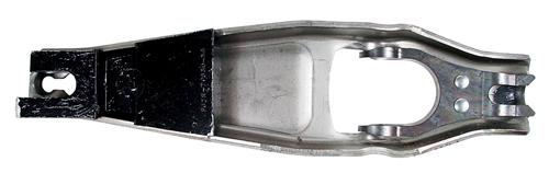

-I'm replacing the clutch fork this time. The FRPP piece appears to have counterweights, feels like a heavy duty, American made part
~Did You Install A New Throw Out Bearing Sleeve Tube?
No I couldn't find the sleeve the tob rides on anywhere.. I actually went to the ford dealer to get all my parts and they ordered me a sleeve for a sn95 I'm assuming cause it was nowhere near the same lol.
I also had them get me the oem clutch fork. I actually heard they got recalled later because of a problem that they wouldn't stay on the pivot ball, they would work their way off of it. Mine did that I just figured it was normal since it was a brand new part and installed it anyways. 1k miles later and it hasn't slid off the pivot ball yet but I still do have the vibration as I did with the old eom fork also.

I got this one from LMR. Came in Ford Racing box but it looks like the same one listed as just "Ford". Mine is stamped with "XR33-7515-AA" on fork itself. Ford OEM is stamped with "XR3Z" instead of FRPP "XR33"
Don't know what the difference is yet.

Originally Posted by robb15033 View Post
YO! YO!
I Figured Out How To Adjust Clutch Pedal & T.O. Bearing Release Point On Pedal Height!
~My new clutch has 4-5 hundred miles on it so it was time to tighten up the cable a little bit. I went crazy overboard and had the clutch releasing a couple of inches from the floor board by accident.
If you still want to know how to adjust it to anywhere you want, respond to thread and I'll tell you what I've done to move it around.
JUST FYI!!
Would love to be filled in lol but I don't see what more you can so beside screwing in the firewall adjuster?
GHO5T5NIPER is offline   Reply With Quote
Old 10-28-2015, 10:18 PM   #172
YEAH, KINDA.
I was able to have clutch release 2" above floor up to very top of clutch pedal release.
If you have a firewall adjuster, I just pulled the round cable base outwards and screwed the adjuster clockwise inwards towards firewall to get the clutch to release with pedal close to floor board.
Pulled round base cable is connected to, out and spun adjuster counter clockwise, most all the way out to have clutch release with pedal high, away from floor board.
~Is that old news??
It works for me. I can have it pull away from flywheel with pedal anywhere i want.
Problem solved.
Adjustable however anybody would like it., 100%.
Does that help? or do you have something broken???

I guess I'm confused my "the round base cable". What exactly are u meaning by that? My adjuster is screwed pretty much all the way in and it still engages at the top
Old 10-29-2015, 07:17 PM   #174
I will take a picture right now,
Stand By-
Old 10-29-2015, 09:25 PM   #175
OK, Here are the pictures:
THE ROUND BASE WITH CABLE CONNECTED EXTENDING LEFT, OR DOWNWARDS IN FIRST PICTURE HAS A KEY SEPARATING WHAT IS WHAT I PULL AWAY SO THAT I CAN THREAD THE ROUND WASHER WITH SERRATED EDGES ALL THE WAY IN TOWARDS FIREWALL IF I WANT CLUTCH TO RELEASE AN INCH FROM FLOORBOARD, OR.. LEAVE IT THREADED ALMOST ALL THE WAY OUTWARDS LIKE IN PICTURE TO RELEASE AT A HIGH PEDAL.
The zig-zag serrated teeth is what you grab a hold of and spin inwards and outwards. ( You Got Me?) Understand where I'm coming from here??
