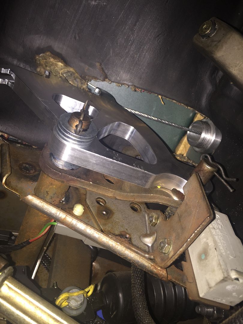

OP, do you have a picture of the cable where it connects into the fork? Did you thread the nuts less than halfway? From the looks of it, your FWA (Firewall Adjuster) is screwed waaaay in.
Try unscrewing the FWA until you get the threads exposed as the pic below:
