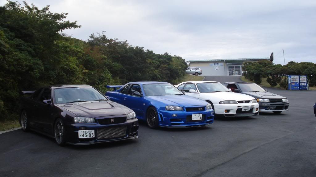

No problem and thanks for the info. Some of us from the GTR club just completed a days worth of driving on the IZU Skyline,(of topic but cool) it's near Mount Fugi. It's nothing but curves going up and down, I just about pissed myself.

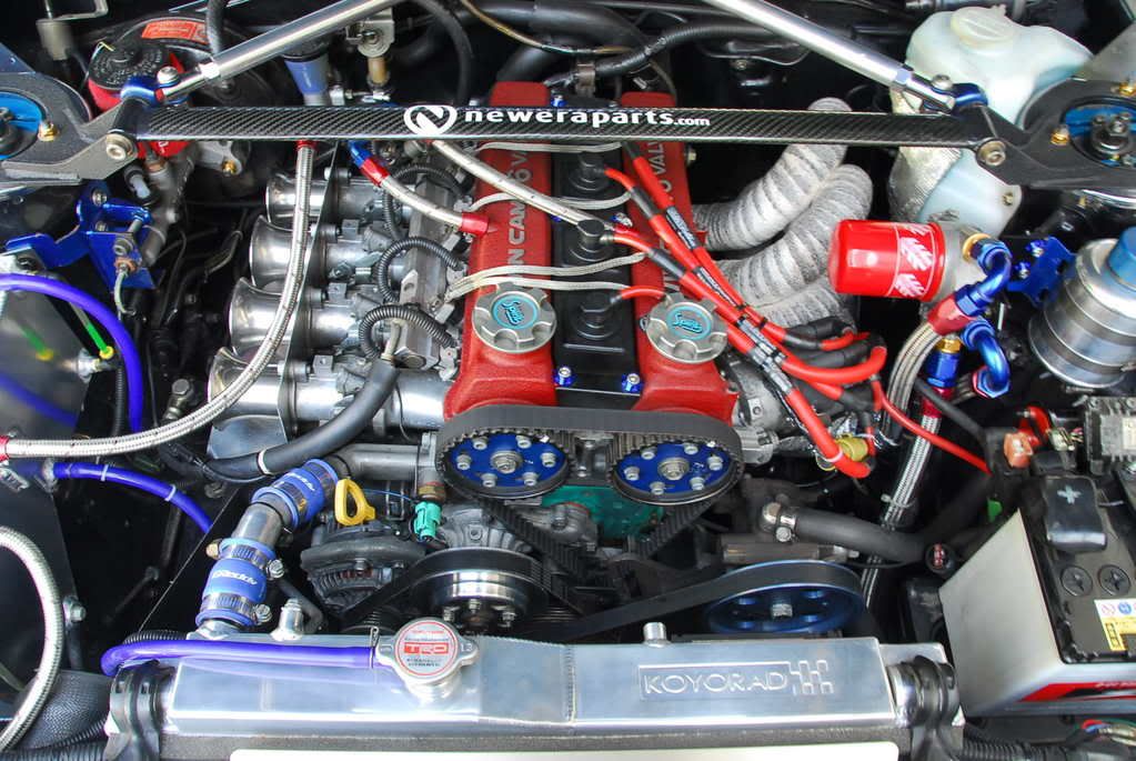

Mine is the white one, pushing 381 at the wheels. The blue R34 has some external bits added to it, tuned, no record on power but has to be around 500 as I couldn't keep up with him on the highway. The guy that owns it is insane, good driver but crazy. The Purple looking R34 has a top secret motor in it, 2.8L stroker with one giant turbo. For now he has the boost down around 18 or 20, still able to leave the blue one though. The other (Corrolla) is an AE86, weighs just over 1500lbs as it has been stripped, the N/A engine puts out over 230 at the wheels, it is fast. Hopefully I will be able to post some video soon, just don't make fun of my redneck voice.
JP
The AE86's motor;
