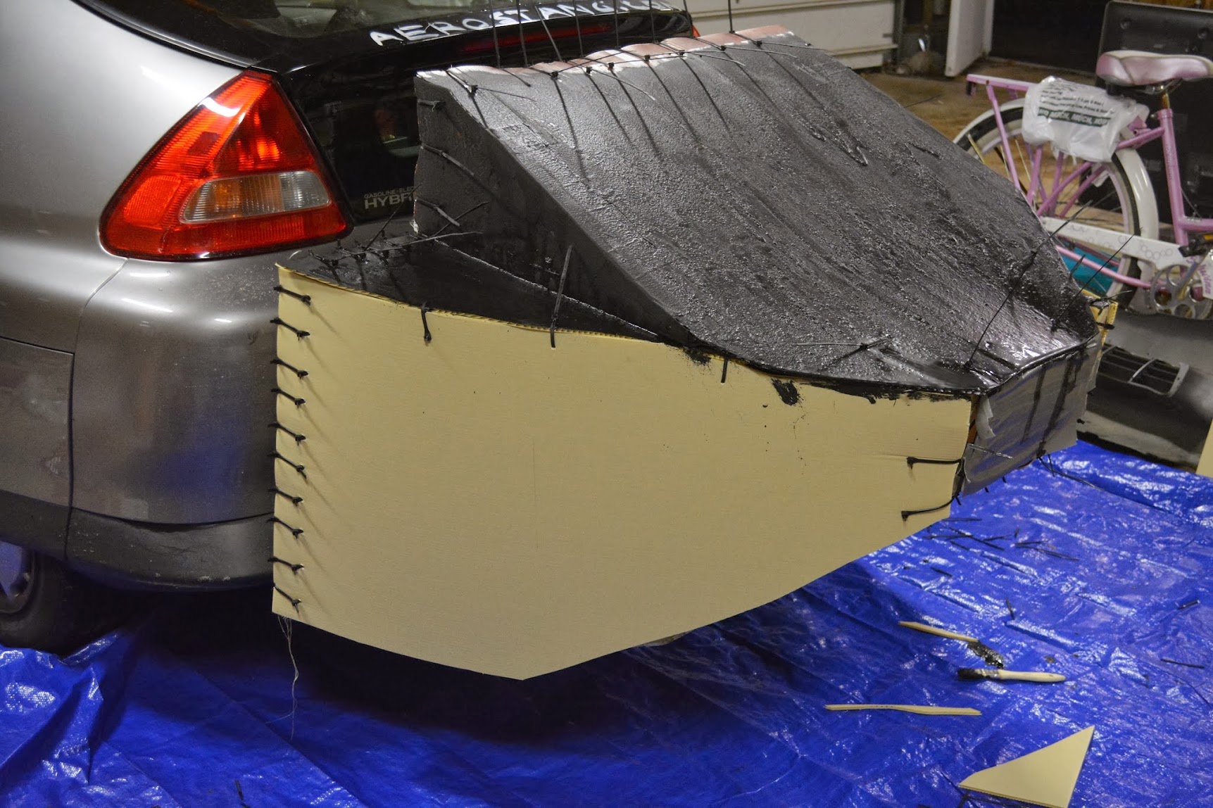

My current supply:
Original build for rear end flow control:
Current model:
Note, the rubberized coating on the top and sealing the sides looks different dry, and the sides are now sealed the same way but with a silver version of the same product. All of the ties are now clipped, too.
Upper Grille block on the Insight (doesn't have to look good...it's a Honda):
Mirror Delete:
Still looking for the underbody photos- but as you can see, anything can be done with polycarbonate lol

I've seen your post in the past and it got me into the whole fuel efficient concept. You can have power and still get good mpg. I remember the grille blocks and you made it so that the holes in te grille were blocked off. So does the air come from the giant gapes in the lower grille? Does it run hotter? That also polycarbonate, or was that metal?
I've seen rear flow type things on some semi trucks on the rear of the trailer and they have lower trailer skirts to keep the air moving smoother. Also, I'm down south in Alabama.

I actually block my lower and upper, for a while now. Air gets in from all the little openings, everywhere. Especially so when moving. I don't really sit still long enough to see if it would over overheat. I never got the needle to tip closer to Hot than Cold, temps bounce between 212 and 220. Yes, it runs warmer, but warmer helps fuel economy to a point (an overheated engine does not run well, but cars this new and maintained don't overheat easily-never happened to me, not even running 440 miles on the highway, which is when I hit 46+).
I guess the question of it running hotter is a yes no. No, it doesn't hit any temperatures it wouldn't normally hit, but yes, because it reaches it's preferred temperature faster, and keeps it better.
It's pretty cool, truckers have used grille blocks to keep their engines warm for decades (some people will tell you it doesn't work ), and now the smarter companies are even using the kammbacks
and side skirts.
Grille blocks on a few vehicles:
Race built 5.0
A few of these keep bigger openings, but for how much air they need, combined with the lack of other openings for air to passively move through, it makes sense.

This is in my dd focus. I drive the same 60 miles 5 days a week. I leave for work at 545am and leave work after the traffic subsides in the evening so my data is about as precise as I can do it without running machinery. I also have weeks like this one where i've done over 1000 miles of highway driving on the same exact route. Focus sucks at highway though, only averaging 31 mpg at 78 mph.
Old 12-14-2013, 04:10 PM   #20
UltArc's Avatar
Posts: 1,782
[QUOTE=Whitelightning;1900638]
Originally Posted by NewMtang View Post
sorry for the bold but is THAT THING REAL OR HAVE I HAD TOO MUCH ALCOHOL?
---------- Post added at 01:18 AM ---------- Previous post was at 01:15 AM ----------
Not worth it? I get nearly 32-35 mpg and my car is mostly highway? I'm not in it for performance, I'm in it for the heritage and legacy of owning a 50 year running car and to show people wrong; that a pony car can get insane mileage.
I'm deleting my antenna and adding new splitters next. Every bit helps. Why not?
---------- Post added at 12:34 PM ---------- Previous post was at 12:31 PM ----------
Do you glue the plates together? Or do you Have them tightly woven or tied together. Trying to develop it on paper first
Heck yes! My signal was not altered by removing the antenna- what altered my signal was Best Buy cutting the radio wire But agreed, one single thing may not make a difference we can calculate, but like Tony Defeo said, "Don't look for one place to lose 100 pounds, look for 1600 places to lose an ounce."
I can NOT find about 14k images right now. Which includes my underbody images. What I did to attach it was map out the exact points I wanted to attach it. I then took these metal chunks, very flat, kind of looks like an "E."
I was going to try to describe it, but instead I will "make it."
1|A
2|B
3|C
Imagine that is all one piece (don't imagine the numbers or letters). I would hold the polycarbonate up in the place I want, then use a permanent marker to out line it. Then, a knife and a candle would slowly turn it (try not to tear the PC), and make a hole on one side, slight puncture on the other. Remember, you want to keep the PC in as good of a condition as possible. The better you treat it now, the longer it will hold. I have had zero issues with any builds, but I also over build. These slight punctures will occur at 1, 2, 3, A, B, and C. Slide a zip tie (I use at least 75 lb strength) through 2. Wrap it over whatever it is connecting to, such as the frame or K bar or whatever, then bring it back through B, put the metal piece up, and then secure the zip tie into itself. Keep it loose, so you have space to work on 1/A and 3/C. You do the middle one first because it will hold the piece in place. Do the other two sides, and it will hold up. The reason I did this, is because there will be other forces acting on the underbody. It's not always just air smoothly floating underneath. So that it why each point I attach with, has three holds. Also, instead of the PC being pulled on by one point (two openings), or three points (six openings), it has one larger multi angle chunk, which spreads the force- making it less likely for the PC to tear.
One thing to keep in mind, is that you want to fish scale it so the front end covers the middle, middle covers the rear, and rear tucks/integrates with the rear end. This can be great, or bad. Great if you can do it one sitting, start at the rear, work your way forward. But, if you can't finish it in one sitting, an underbody can act like a big parachute if air is flowing underneath and has no escape route. You may notice I leave openings in my builds. My underbody does integrate with my rear valance, some parts under, some above, alternating. BUT, the sides at the rear are specifically open so if I am getting air underneath, it can escape. I'm smart enough to know I don't know everything, and know I can make a mistake- so I try to give myself some leeway.
That doesn't seem bad at all. What year?
Ford Focus MPG Reports | Fuelly
EcoModder Fleet list - EcoModder.com
Details: Aerofocus - 2000 Ford Focus ZX3 Fuel Economy - EcoModder.com
Nice little build on a Focus air dam & front section belly pan.
Ford Focus front belly pan - Fuel Economy, Hypermiling, EcoModding News and Forum - EcoModder.com

Found my images!
Backing up to Ramps
Prepping the board to be attached
Close up of attachment design
Look at how dirty this underbody is! C'mon Ford
Attaching
Secured, but not tightened (to maintain work space)
Laying the line, not tightening yet
What it should look like attached (view from ground)
Rear sway bar attachment point
Working rear to front
Mostly done
Upper grille block after almost a year
For a 2012 standard V6 Mustang, aerodynamic drag is greater than rolling resistance before 5 mph (Aerodynamic & rolling resistance, power & MPG calculator - EcoModder.com)
, while the V8 sees the same standard (Aerodynamic & rolling resistance, power & MPG calculator - EcoModder.com). Please note, these numbers are based on summer conditions and summer fuel.
If one can improve the v6 (~280 hp) CD by 10%, the top speed (if only limited by power and aerodynamics) increases from 165-170 to 170-175 (Aerodynamic & rolling resistance, power & MPG calculator - EcoModder.com). The v8 (~380 hp to wheels) seeing a 10% difference would go from 185-190 to 195-200 (Aerodynamic & rolling resistance, power & MPG calculator - EcoModder.com).

So start at the front, then middle and then least. What's that piece of metal on the signs? Just to help it stay attached? Now that I see this.... I'm a vast over thinker
Any Speed over 55 mph may kill you... that's why i drive 60
Whitelightning is offline   Reply With Quote
Old 12-16-2013, 09:55 PM   #25
UltArc's Avatar
Posts: 1,782
At one point I made the diagram with the numbers and letters. That spreads the force out so its not pulling on just one small section.
The same force spread out holds it better. I just want to make sure it doesn't come off, and this works for my build.
