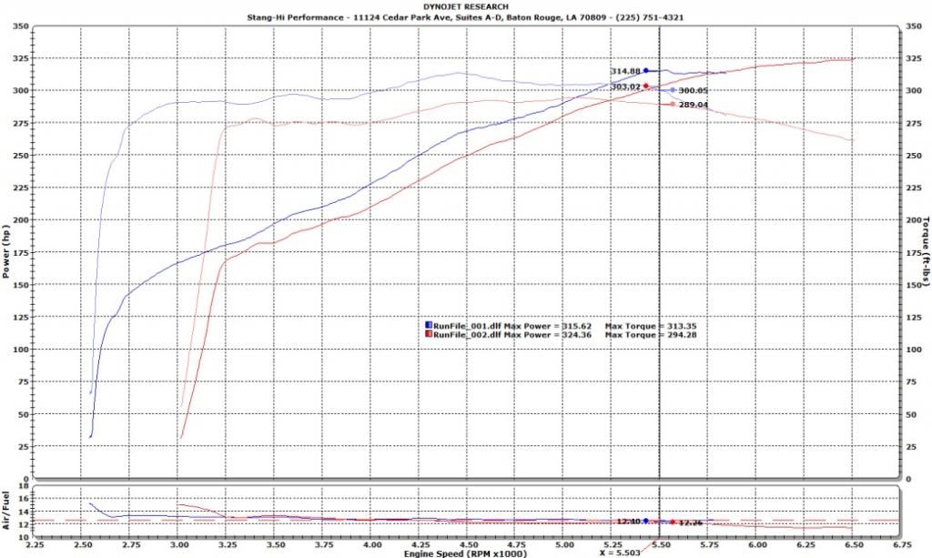

Few days late to this but here ya go.
The throttle body is a waste of cash unless you're boosted. The factory manifold provides enough flow until you get into a boosted application so save the cash. Also, I would skip the TCI tq converter as it's just a rebuilt stock converter. If you want a good tq converter, try looking at PI (performance industries). They stamp their own shells and provide internals, they're a more stout converter.
I haven't had any issues driving mine and it's still on the stock gears (3:31) and tq converter. I've got a Steeda CAI, ARH long tubes with a catted X, and the hot rods. The thing is fun as hell to drive. I don't have an email tune though, I took it to one of the best tune shops in the south and had them dyno it so she runs like a scalded dog.
These were not wide open pulls.
FRPP HotRods Cams / American Racing Headers Long Tubes with catted X / Stang-Hi dyno tune
Saleen wheels / Steeda CAI / Corsa Xtremes, K Springs, Koni STR.Ts, UMI lca relo. Brackets/r lwr ctrl arms UMI adj. panhard bar / Camber plates / SR Strut Tower Brace.

Originally Posted by 32GT32 View Post
Ahh man yeah my friend told me why I wanted a throttle body and manifold intake if I wasn't boosted a few people said they could feel a difference but I just ordered my cams today what do you think I should get next? I have pypes bomb x pipe pypes bomb axle back Obama custom tunes jlt series 3 cold air I'm gonna switch out the exhaust and go jba h pipe and jba long tube headers. And still have 3.31 gears like you I wanted to cut down my 1/4 time so I wanted to go 4.10 that's when people mentioned about the stall and all the other stuff that could help me out
I would grab a set of 3:73s unless you plan on going with a full blown tubed race slick. I've seen some guys get 4:10s because it makes them feel faster on the road and then they end up spinning too much at the track and then blame the tires. 4:10s can be problematic IMO with the 5R55 because the first and second gears are already short enough.
If I planned on being at the track a lot, I would spend some money on the mishimoto trans cooler with the electric fan and run a switch under the dash so you can run the fan and cool the trans between runs. Heat is a killer in automatics. The 5R55 also needs to have the second and third gear bands replaced with tougher ones if you really plan on making a track car, and even is street cars with power they're the weak points in our transmissions.
As far as exhaust goes, I'm running ARH long tubes with a catted X and corsa extreme mufflers but exhaust is highly preferential so the sound that you enjoy is totally up to you. I do recommend a dyno tune with cams and long tubes though, email tunes won't be nearly as good.

I haven't been back to the track since I installed the cams, long tubes, and had the car dyno tuned. Thanks for the compliment!

What was your synonymous numbers Destination S19?? If you don't mind me asking
---------- Post added at 11:14 PM ---------- Previous post was at 11:13 PM ----------
Sorry meant DYNO #

The highest it showed before he had to cut the final run short was 324rwhp. He stopped it around 5500rpms because the head temps were getting high. It was near 100 degrees that day with high humidity. He made an educated guess that if he had kept into and ran it to 6500 it would have put down 340 at the wheels. The torque table was just that, a table, you could have set a plate on it. Tq was 313.
You can see where he had to cut the run short in the graph and how flat the torque is on it, thats impressive if you ask me. Nice amount of torque through the whole power band.
