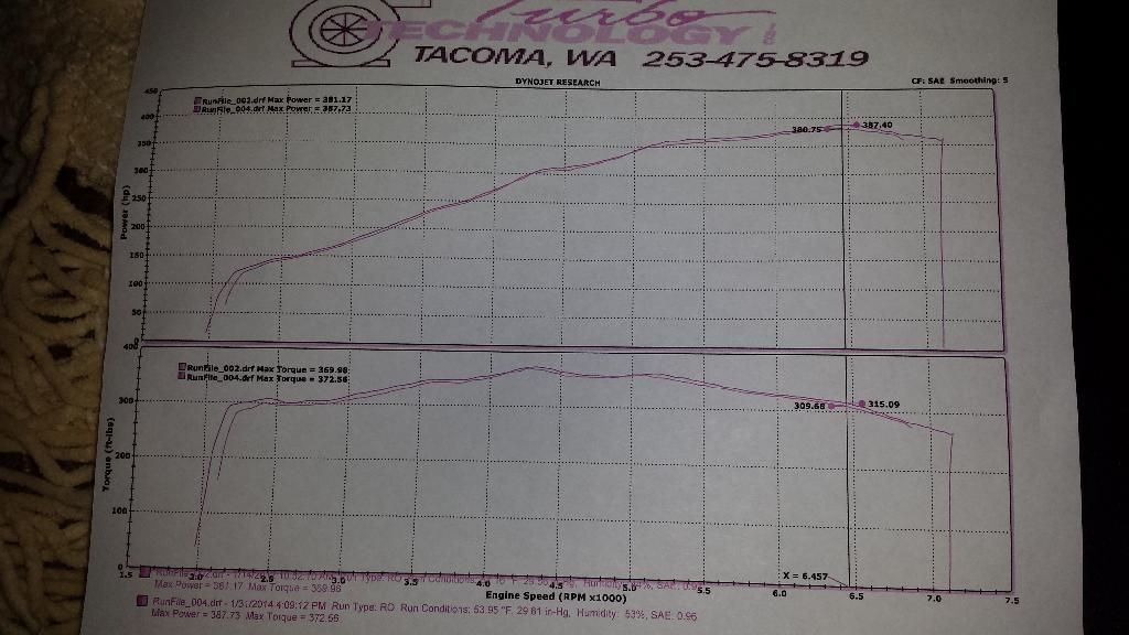

Here's the difference between stock (Roush axleback only) and the Bama "race" tune with a K&N drop-in filter. Car is a 2011 GT.

Doesn't seem as good of gains as I had thought. Definetely not worth losing my warranty for 7rwhp. Does the cai + tune make much of a bigger difference?

We'll see. I've been holding out on installing anything else until I got it dyno'd with tuner only. I have a CAI and Boss manifold in the garage. Might start tomorrow, then dyno'd again.

"POWER
2011+ GTs have dyno proven gains of 31 RWHP and 37 ft-lb's of Torque or more on Bama Custom Tunes. By adding more fuel, optimizing the air/fuel ratio and tweaking variable cam timing, a Bama Custom Tune is proven to squeeze out the extra horsepower that Ford left on the table."

This thread covers "how to" drop $400 and gain 7 hp.

Put your question to the vendor and see what they say. Every car is different. I look st the two runs and see the curves are virtually identical, which suggests to me the tune did not get written correctly, flash back to stock and reload. Tuned should feel markedly different, at the very least, indicating its presence.
I've maxed out at 439 flywheel, calculated from dragstrip times on my canned tune.

The most positive gain I saw was the throttle response, otherwise feels the same. When I got home I plugged in the tuner again to check if I had even loaded the race tune, made me second guess lol.

Yeah, no kidding. There should be a pretty dramatic difference, even putting around. 93 "race" tunes are not susbstantially different than a similar street 93 tune, except mainly in the more instant tuning of the throttle response.
You can see your little low end bump on your torque curve but otherwise, this tune is crap. You should be picking up solidly from the midrange on up, particularly and you're flatlined.

I also put my bama tuner on and wasn't that impressed.. After a while I had to take it off for a short time and that's when I noticed the diff.. Mid range to top end dropped off drastically with it off..

I'd be making a phone call about that one. If that's all you get i'd want a refund and take the money to someone else that will give you 20+RWHP For $200-250

Maybe BAMA will chime in? lol.. that tune is bad. Thanks for sharing! Good Base numbers

Those gains definitely seem low. We can look into this for you and we'll make all necessary adjustments. As you can see, your car makes a lot more power in the mid range and the top end, compared to stock. Your stock tune completely falls off but the Bama tune continues to make power.
The most important thing is how does the car feel? Do you feel a big difference over stock? Also, what kind of dyno was this on? Were the runs back to back? Same day? etc..
Shoot me a PM with your order number included and I'll have a Bama tuning specialist reach out to you directly.

I don't care for butt-o-meter stuff Dan, that's why I spend more effort and money for dyno time to help verify gains. I used the same dyno for consistency, I believe it's a dyno jet. I've tried a Mustang dyno in the past, but no one believed the 399rwhp it put down there stock, so I went back to this place which I've used for years in the past with a Camaro I used to own, and it's known by many in the local area to be conservative.
I'd like to see a bit more of a gain before I put any more parts on the car. Maybe this is it I don't know, just a little deflating when people claim quite a bit more, and I've seen guys get the gains you advertise but right now it ain't happenin' here.

Yeah, like I said these numbers are low. We will help you figure out what's going on here. Please shoot me a PM with your order number include and I'll make sure you're contacted right away!

Here is an article about Shaun from AED and his tunes. Car only picked up 12 hp and 13 ft lb but .66 seconds on the 1/4. Not comparing AED to BAMA in any way, just pointing out that your gains aren't necessarily telling the whole story.

Over the weekend I already put the car back to stock and downloaded the new tunes for the new parts. Only way to dig into this further is if I have Bama send the tunes again and spend the time to sort it out, or just throw in the towel and install the new parts and tune and go from there.
