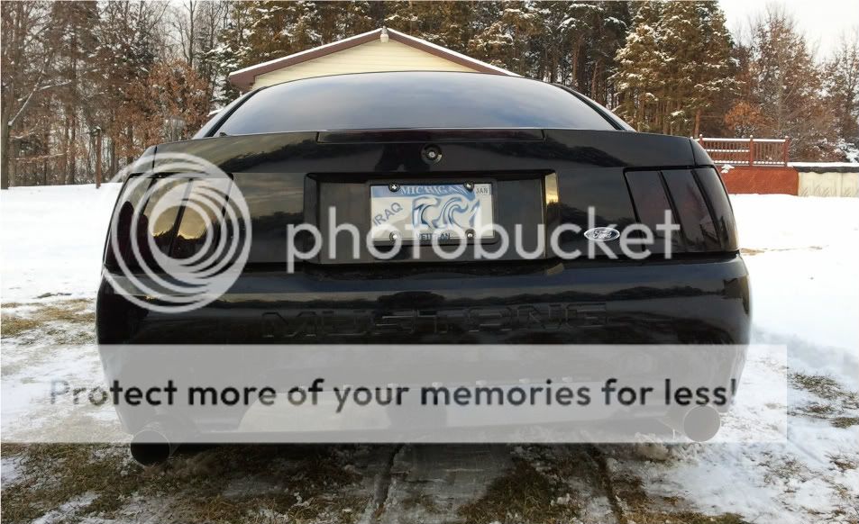

The tint is too much of a hassle. Do the VHT Nightshades (how-to's all over youtube) and clear coat them. Easy to do and cost 20$-28$ (Amazon.com) if you already have a microfiber cloth and Dawn dishsoap..hehehe

In Texas the painted or VHT won't pass safety inspection. Tint you can take off. I would buy a spare set but they are really expensive for just to use during inspection.

Did mine myself with the vht paint because I didn't like how dark my overlay from AM was. I love how it looks now its realy barely tinted at all but just enough to make a big difference.

I had the vinyl overlays on my old headlights and only once did it come off almost during a downpour.
I used VHT Niteshade on my tails.

Can anyone tell me whether or not you need to use sand paper when you use VHT or can you just spray them and then clear coat? I have the VHT but am wary, just don't want to mess up my lights. But I do want them black with no bubbles.

It's recommended to do a very fine standing and then wet sand. On my 04 I didn't sand and it came out to a matte looking finish

The 2000 grit sand paper (wet), scuffs the surface a little for better coats. It will eliminate orange peel effect. Wet-sanding is the only way to go for a good job. Otherwise, buy you a set of used taillights and spray those. A job done right is a job well done!
There's HUNDREDS of videos on Youtube that will show you STEP BY STEP how to do them. Its dumb proof, turn video on, follow step, pause, press play for next step...too easy!
