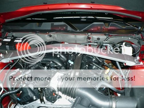

I got the Ford Boss302 brace.
If you get one, Any one.
Do not over tighten the nuts that will hold it on.
The studs are very easy to twist off and cost you over $100.00 to repair.
The nuts are locking nuts and only need to be snugged down, They are very easy to twist off the studs so be very careful.

<snip image>
Also worth noting that according to Ford those nuts are one-time use, so they are supposed to be replaced after each use.
The vast majority of people don't do that, but I would certainly not plan on reusing them several times, as the 'locking' quality will be lost the more they are installed and removed.
Also, Get a Brace! The extra load path, the load triangulation, and the stiffness increase in the front end are worth it for all but the most silly overpriced of braces. I know the OEM Boss 302 brace is available from lots of vendors at a reasonable price.
Good Luck!

Those nuts are torqued to 26 ft/lbs

I did not twist any off
I just wanted to warn anyone about the danger of twisting them off. I do have a torque wrench and I do think that 26 Ft Pds is still a little to much for this size nuts.
All they need is to be snugged down until they are seated and walk away. Use new locking nuts. A drop of locktite wouldn't hurt either.

No re- alignment needed.
Just pull the nuts off, place your strut brace on and replace the nuts. I advise getting new ones. I see some people just use the old one's. (NOT ME)
Just do not over tighten them when you put them on.
