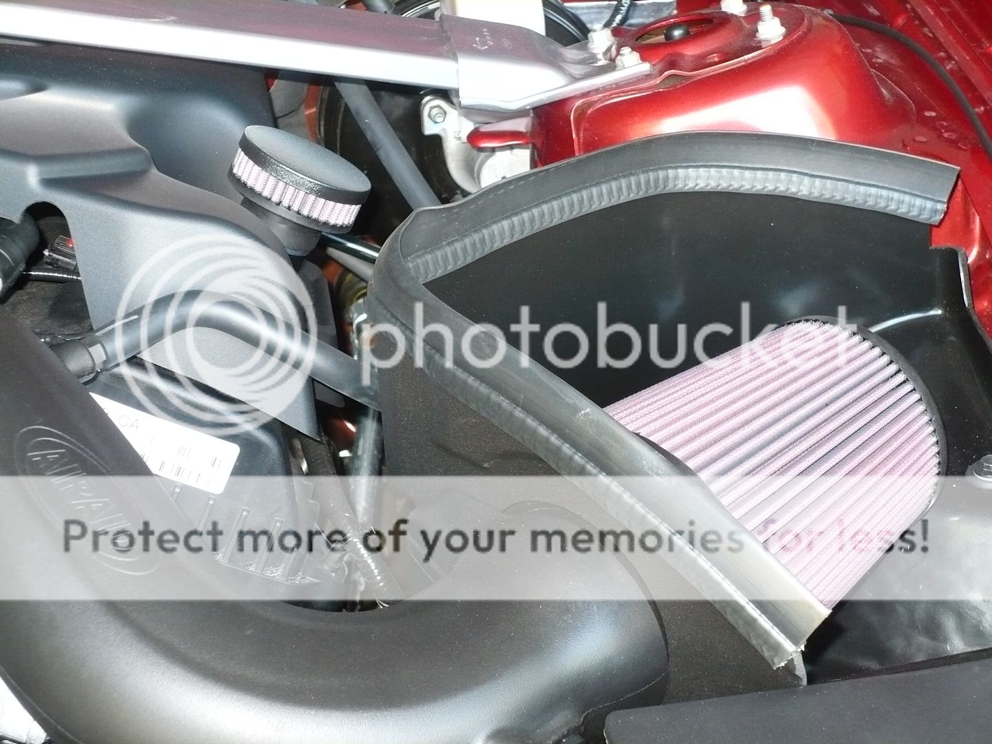

I did not have to modify anything on my Airaid
BUT if I seen the hole was not large enough I would just get some sandpaper and stick it around my finger and enlarge the hole to size needed. You will learn over the next 50 or 60 years of fooling around with cars you will need to actually look to see how to make some of this stuff fit perfectly.
Your lucky you are not into modifying Harley Davidson Motorcycles. Nothing ever fit on one of them right out of the box.
If you look very close you can see I had to cut a notch in my engine cover to fit.
The engine cover was not made for the Automatic so a slight alteration was needed.

Originally Posted by Sakib View Post
Lol. Love it.....
I don't want to be misinterpreted as bashing those folks. I'm saying that their reasoning is not based on performance, and there is nothing wrong with that. Is added a Stillen chin spoiler to my car, not because I delude myself into believing it will make my car faster by increasing down force. I bought it because I think it looks cool.
Well I agree its a great under hood appearance mod! That's why I got one on my V6. Put I don't want to repeat that again, the air temps would get really bad on an extreme hot day. There is one expensive CAI that has a closed off box, that guess what? You can open the top of the box for a car show and see the Cone filter!
Art

Old 08-18-2014, 07:08 PM   #104
Art
What filter is that?

Originally Posted by WileECoyoteGT View Post
Never heard of the aRe filter, but always interested in a better product!
Sorry typos, changed my post above, it is Afe filter.
aFe 30-80179 Direct Fit Inverted Replacement Filter
