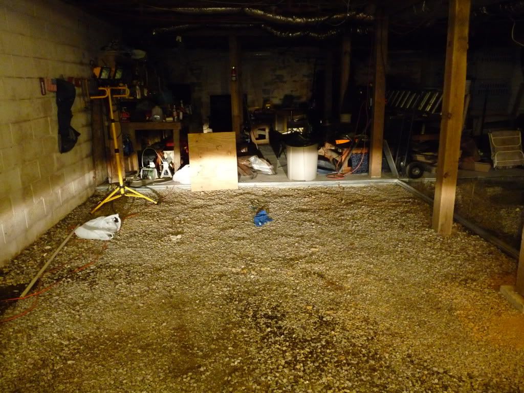

Old 11-17-2014, 03:55 AM   #14
Siber Express's Avatar
Location: Clinton
Posts: 1,152
5 car? Pics?
52 feet to the first column that blocks access all the way across on one side and you can get a Saturn and Ranger on the other side, right now it is 2 car with all the crap in it, but it is also the whole basement of a 66 foot long house.
The only picture I can find, the car is all the way in, that is the columns that is 52 feet from the door.
I have finished the concrete though
