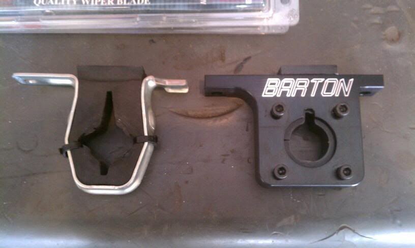

The issue is the stamped stock bracket with the rubber insert. It allows a lot of slop, hence the chance to miss the 2-3 when shifting quickly. So far I have had no missed shifts with it, here's a side by side pic, kinda explains itself......... it wasnt hard to install other than at 46 my close up vision isnt what it used to be, expecially stuffed under a car on jack stands in the driveway. Took about 45 minutes to install.

I can sympathize with you on the vision...I am 44 and have the same issue. Looks like it could be something I can do. I have access to a hydraulic car lift so that should make it easier. Thanks for the tip!

That is one of the complaints with the Barton shifter. It transfers more noise to the interior. I am guessing since it is a solid mounting surface the sound transfers more. I was going to go Barton but after reading about the MGW shifter, It looks a lot stronger. Not that I shift that hard, they seem to include a lot of extras with their kits like sound deadening.

Any solid mounts will have a similar affect.. Trans mounts, motor mounts etc have similar issues

I could do that shifting before the bracket but it wasnt consistent, there were a few times of 2-3 where I hit in between the 3-5 gate and when that happens the spirited driving has to slow down. I figure that was due to the stock rubber piece that allowed way to much movement.......... as of now I havent had the transmission fluid changed

--I just got the Barton Shifter/bracket combo---& my Bracket has a piece of RUBBER glued to it-I'm guessing the Rubber piece will ABSORB some of the NOISE/Vibration that folks are hearing after installing the Barton shifter bracket..??
Did YOUR Bracket have a RUBBER Piece glued to it??

Yes, a small (1" square or so) on the top. I was assuming the same thing, noise absorbtion. I do have a lot more noise transfer, nothing that bothers me but it does transfer more than stock. And the improvement in shifting is well work the added noise
