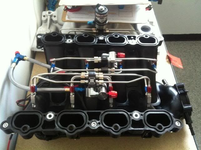

Posts: 3,606
Re: NOS kit
Go direct port. Best way t o do it right. Also you can hide it a lot cleaner. Completely under Boss intake. WIll never be seen less really look for it. This is Sean Kelley's new set up on his 9.2 1/4 mile car that will take him to the 8's and hopefully set a new fastest 5.0 record.
wnt2gofst is offline   Reply With Quote

Re: NOS kit
That's ****ing awesome!

Posts: 3,606
Originally Posted by white2011gt
How much is the Boss/NOS setup?
You would have to call nitrous Dave's in Waco TX. I would imagine least 800. That is you sending them your boss intake.
