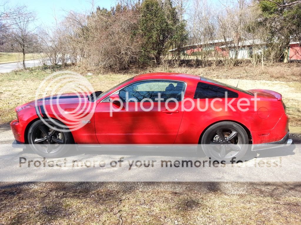

Well got an electric impact wrench and bam easy as cake. Now I am just waiting for my helper to get here so we can get the CC plate bolts in and then I am in business to finish the rest tonight. Hope Tire Discounters can do my alignment tomorrow.

I hear ya....You cut some off the bumps? How much drop are those springs? You need any TQ. specs on susp. stuff give me holla. I got about all them or ones that seem most important IMO. Glad you getting done bro.....I have had mine on for about 7 to 10 days. Hell they layed in my floor since december. Was just waiting on decent day of weather. I also had to send one of my front konis back, noticed it upon arrival. Brand new and bad out the box. Just one of those things but they took care of me.

I didn't yet actually. I wasn't thinking when I responded to your PM but I got the FRPP bumps that are intended for lowered cars. Figured I would just see how it is first. If it bottoms out to much I'll cut them. Since I have the right tools now to do it no big deal.
I got the TQ specs and followed them pretty closely, specially on the CC plates.
The front end is done and I am going to go do the back end here real quick. It looks easy compared to the front which is why I wanted to do it second.
Initial impressions, the car sits perfect. I wouldn't want her any lower and as for height it looks perfect.

Cool....If its not out bad with how it feels I would drive it a day or 2 then align. Not a bunch of miles but give it some settle in. The OEM bumps are gonna have to be cut or it will be hitting more than you think I believe. Like I said you may wanna get some more opinions on that.I am not sure how much drop your springs are-How much? The FRPP ones you got......How much shorter are they than OEM? Curious about this? Yes,The back is simple.You will need to put a wrench on top of shaft on top side but easy to work with.

I want to do that but I either align it tomorrow or align it thursday after putting 350+ miles on her. I work 12 hour shifts and won't have time else wise.
They are the same length but feel different. almost more forgiving? I just took the stock stock bumpers out and have them sitting with the stock parts. I left the stock rears ones in ATM because I need a Hex key to get them out. Doesn't use a standard wrench bolt. Dunno why they decided to do this. The new ones have the same dang botls but the back ones are designed differently.
Either way I just test drove her on a few curvy roads and a few crappy ones and she didn't bottom out and handled like a beast.
the springs are a 1.7" drop in the front and a 2.4" drop in the back.

Koni Str.t shocks and struts
Springs your choice
Caster camber plates if dropping this low
Pan hard bar.
Going to order LCA and relo brackets hopefully next week.
Ride is very stiff and very smooth 90% of the time. When I do hit something that makes the car bounce it throws you kinda hard. I know I'll hit the roof some day.
But really it isn't uncomfortable. I guess if you ONLY drive bad streets it would be terrible. You definitely feel the small ledges between asphalt slabs if they are off and don't hit pot holes at all period.
I love how low she sits I just need some 19" to fill Tue gap out better. Might do wheel spacers too see of that helps. The front looks a little too tucked now.
In person was an insane difference. 2.4 in the back doesnt seem like much but she feels low when I walk up behind her. Like instead of looking kinda at the trunk I have to look down.
I won't have to stand on the rocker panel area with the door open to wax the roof anymore
Oh, 0 nose dive on breaking, stays flat as all get out on turns. And just over all handles better. Acceleration sucks but the LCA and relobrackets will fix that.

Well it really isn't the struts. Its the springs. 1.7" drop in the front and 2.4" in the back is more than your sport lines no?
Grabber blue can throw his insight as he has them with a 1" drop I believe. His are more realistic to what most people will do.
