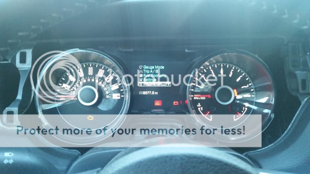

The second Image doesnt show the track apps, Idk why It wasnt there then it was after i got the pats to program, I did forget to mention that now on the Radio LED display all the way on the bottom left it has two --. Im not sure why its thee now, Came on after the cluster install
tsiawd is offline   Reply With Quote
Name:	ImageUploadedByMustang Evolution1420727999.363222.jpg

Attachment 173131
Fantastic! Ill probably do that tonight then!

I'm at the dealership right now and we have the new cluster in however the "service advancedtrac" light is on. We did the pats relearn and the as built so track apps is on. Should we just try different codes?
dougvandy is offline   Reply With Quote
Old 01-08-2015, 11:58 AM   #628
Location: Baltimore
Posts: 22
I dont think the advance track has anything to do with the cluster. Just for giggles swap in ur stock cluster real quick and see what it does

DVandy,
Are you sure you are using the right codes for a 2014? None of this mod should have anything to do with your advance track tho.
BTW, hope anyone doing this from now on has already downloaded your ASBUILT codes because it looks like Ford has shut that door
2013 GT : 6sp MT, Track Pkg, 3.73 Rear End, Brembo Brakes, Vortech V3 SC, Boss IM, BBK 90mm TB, JLT CAI, ID1000 injectors, BAP, Brisk Plugs, Tial BOV, Lethal OR X Pipe, 3" over axle to GT500 Quad Exhaust, Dynotech Alum DS, MGW Shifter, Eibach R2 Coil Overs, Bob's Billet LCA's, UPR adj. UCA, Eibach Adj PH Bar, TruCarbon Carbon Fiber inside/out. Tuned by Jon Lund II Three salvaged Bosses worth of Parts live on in this car. 705.11rwhp 5.33pulley/Torque Booster Wastegate
