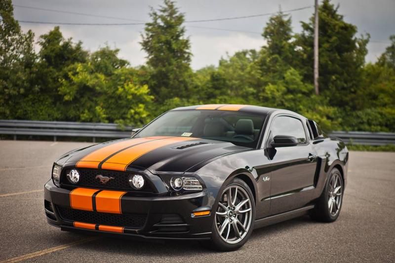

This is the setup I would like to buy, but I am afraid is going to be too low and scrape the road. What are your thoughts? Is this is a right setup? I don't drag race, it is just a DD.

My BMR relo's scrape quite a bit even on a slightly uneven road. Happened twice yesterday, quite annoying lol. Pay to play!

Hey dentman, what are your wheel and tire specs?
Originally Posted by dentman43 View Post
This is the look you will get with 1.5 drop all ford racing stuff , no upper and lower control arms yet those will be installed next week getting the arms from steeda aluminum Attachment 167045Attachment 167046
2014 Black Mustang GT. Roush Axleback Exhaust, Airaid Intake, JLT Oil Separator, Black Billet Grille, Fog Light Relocation, 19" sve drifts with 275/40's, D2 Coilovers, BMR Panhard Bar, BRM LCA's and UCA, KOI and Oracle Orange Dip
