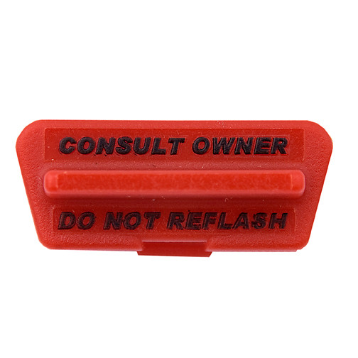

If you are going in for some interior work like that, there is no need to return your car to stock prior to having that work done. You inform the dealer to please not to change any of the engine parameters. Tell them you have a tune for your intake. MOST dealers will have no problem with that. If they do, you need to do business with another dealership. I am personal friends with the owner of a Ford dealership and we have discussed this very thing. Put one of these on if you dont trust them.
I'll bite, where did you get that or how did you make it?
OBDII Port Cover DO NOT REFLASH (200922) - Longhorn Fab Shop
Steeda makes a billet one too. if you want to go all out
http://www.mustangsunlimited.com/ite...?T1=5551260+01

I love that "do not flash" tag. I just bought myself one lol didn't know that existed.
