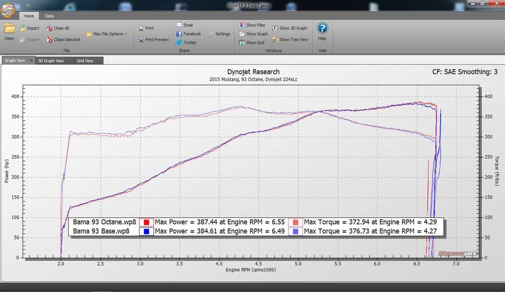

Here's the net result of several tanks of fuel, lots of thrashing on the car, and more than a little patience on my part.....
The base file (blue) is the one that was originally sent with no logging, no drive time.
The 6th revision of the tune (red) is the one after all the logging and thrashing on the car.
The ONLY spot the revised tune out performed the base line tune was from 6500 - 6700 RPM's, otherwise the base file was ahead of it the entire time.
Wow

I'm really surprised about this. I mean he knew you were going to do another pull. He knew it was going to get published on forums. He knew you were not happy with the first go around. You would think he would have gone all out on your tune to save face.
That gain hardly seems worth the effort of loading the tune let alone the price and warranty void issue.

Well, I can't speak for their dyno, but I can speak for this one. I have routinely taken cars off this dyno and gone straight to the track and been within 1% of the dyno results vs calculated hp based on vehicle speed, weight, and ET.
But, I'm not trying to sell a product, I'm the end user and that was not worth the time and effort when the "box" tune from SCT outperformed it.
I'm driving it on the SCT tune now and did a cold start log of it this morning and the surge at 2900 RPM's is gone. One log isn't enough to say yeah or nah, but it was certainly smoother this morning when I left. I can't even see a slight stumble at 2900 whereas before it would make you flinch trying to get past that point.
But, anyways, I tried to be fair and give them the opportunity to make up for the initial fiasco and the results don't justify it. Lesson learned.....but, this is why I normally tune my own junk.

The peak gains over stock were 7 hp with the Bama tunes and 10 hp with the SCT tune. Best stock was 380, Bama was 387, the SCT tune did 390.
The changes being made in the timing looked good, but the overall impact was just less reliance on the knock sensors to correct for over / under timing. Timing is where a lot of your gains are made but the other big impact is the cam timing which had very little done that I could see. Unless you get more air to the motor you're not going to see big power increases and this is where the cam timing comes in.
What I normally expect to see is about 9 - 9.5 hp at the wheels for every lb/min of air you get to the motor and here there was no real peak gain, only about 1 lb/min, it was in the 41 - 42 lb/min range. 41 * 9.5 = 389, which is right where the car did. The gains are going to be dialing in the cam timing to get as much air into the motor as possible.
The timing is pretty close to maxed out, but there is a lot of room to go on the cam timing. Sometimes the gains you see with a new cam or cam timing aren't necessarily higher peak values but what you get is an extended power curve. With variable cams you can see the power come in much earlier and with actual cam replacement you see the power get extended farther out into the RPM's before it tapers off.
