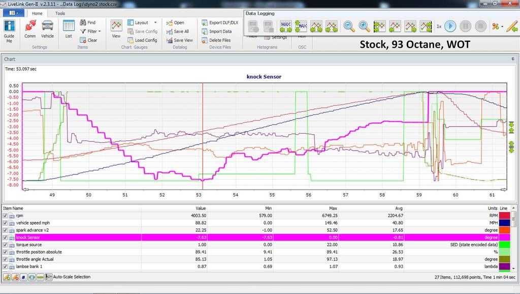

Here is what the car was doing when it was stock at WOT. You can see the timing is all over the place, knock sensors are over reacting, torque management is kicking in, etc....

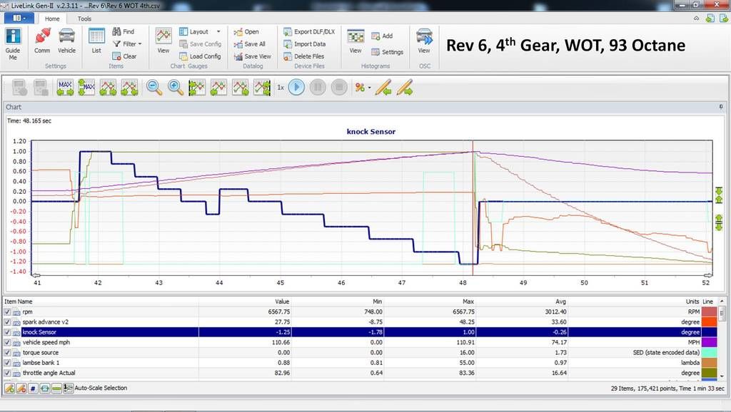

Now, here is what it looks like now. I highlighted the timing and the torque management so you can see the difference....
The car is dead smooth from the instant you smash it until it hits the rev limiter. One thing to note.....with no torque management, when it hits that rev limiter, it tries to lift you outta the seat. It's not a subtle cut-back, it's shut the power off NOW.

This should give ya a real clear example of how much the car was over reacting when it was stock. Timing was way off, knock sensors were going nuts, torque management was kicking in, etc.
I have NO DOUBT that the car is gonna make a pretty significant improvement the next time I strap it down.....especially in the mid-range RPM's. It looks like it's going to make a REALLY solid gain there.

Annnnnd, we're good. It's at the point where the knock sensors are now trying to add timing vs take it away. The car is pulling really well and Paul is happy with the tune, so it's time to strap this sucker back down and see what she does. It'll probably be Thurs afternoon or Friday before I time to put it back on the dyno.
If you look at the logs below you can see where the knock sensors are showing negative values. This isn't pulling timing, this is adding timing, which is what you're looking for. The closer the knock sensor can stay to zero on the negative side, the closer the tune is to being dead on an not relying on the sensors to keep it from detonating.
This was banging 1st through 4th gear.....
This is WOT in 4th gear....
