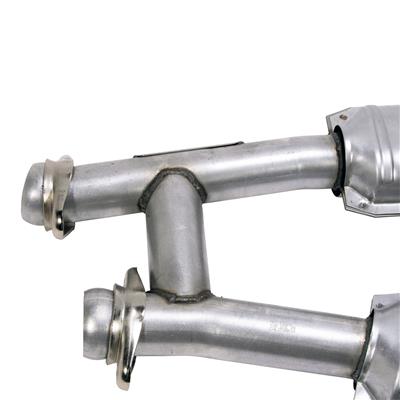

No, you will take off the four old cats. There is something called a "mid pipe" that goes from the headers back to the mufflers. This "mid pipe" is what you will be replacing. The cats are a part of this pipe.
Here's a pic of what you need:
Scary stuff.

So if i understand you right i will unhook the first two cats by the motor and toss them, and this will hook right up to the STOCK hedders and hook up to the mufflers, so all i will have to do is bolt this unit right in. Also will this allow me to pass the sniffer test here where i live, since there will just be two cats. I noticed the 4 oxygen sensor bungs so everything will plug right in. Also will i have to have any codes deleted or tuned out like my ls1? Sorry for not being very smart here, like i said this is my mom's car so i have to make it emission's friendly. But i cant see putting 4 new cats on there and spending a fortune if not necessary. Also should i put a h pipe setup back on there or go with a x-pipe setup that hooks up the same way? I really do appreciate all the help and advice guys.
Yup, this will bolt right back in place. You unclamp the stock h-pipe (with the 4 cats), toss it in the nearest trash receptacle, and bolt this one in its place. You won't have to worry about anything as far as the computer is concerned. On the 5.0s, you don't even have to worry about that with an offroad (i.e. no cats) pipe.
The x-pipe vs. h-pipe thing is more of a matter of opinion than anything. They have a sort of different sound. Judging by what you want it for, I'd just get an h-pipe though.

foxes only have 2 02 bungs, that pic was just an example of what it looks like. you can take off the cats and not get any codes, so you will be fine. just bolt in and go.
