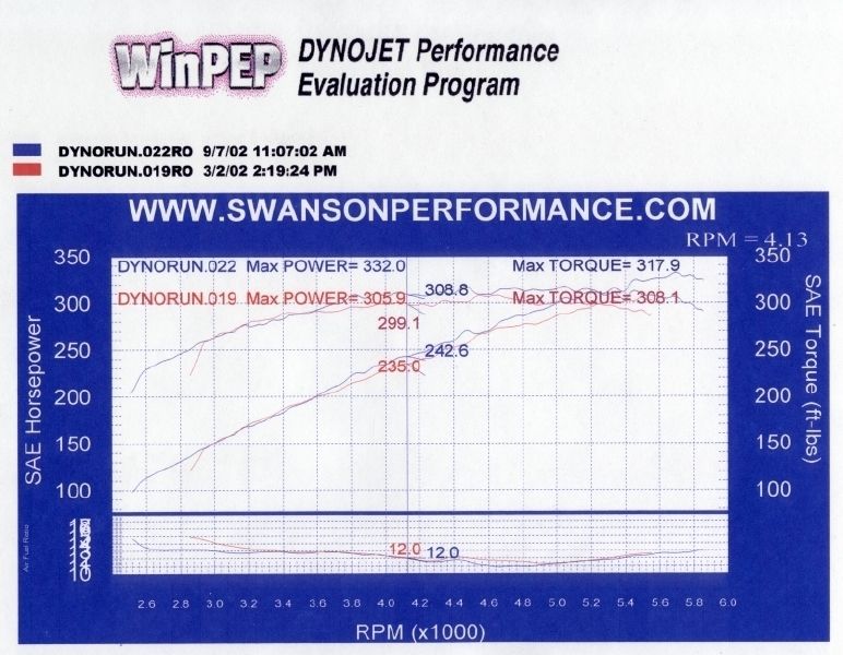

Old 10-25-2003, 09:55 PM   #13
RGR
The Mustang's Human Twin
City: Terre Haute, SC for a bit
State: Indiana
Posts: 1,638
Send a message via AIM to RGR
The dyno graph:
The pic:
another: (the bread ties are to hold the gasket on for shipping)
and finally:
This plenum came out at ~3.7 or 3.8 liters, and it worked well
w/SC! This combo is also the highest known emissions legal
HP setup for a pre-99 V6 going. 332 RWHP & 318 RWTq.
11# ATI SC. Mild cam, stock valve heads, what I call full NA
porting and he now has MAC shorties and full dual exhaust.
Stage 3 over Stage 1 on Jose's engine (NA trim) showed only
a 2 RWHP increase, but good torque at certain RPM's and equal
everywhere else, but when I got it back in trade for the custom upper,
I found that Jose used a stock 56mm TB gasket on it, and
that could have reduced the higher RPM gains considerably.
So I actually do not have a fair comparison between a 3 and a 1
but the 3 did have some nice torque gains at lower RPM's.
Originally Posted by Flex:
You are the true cam master dude...
RGR is offline   Reply With Quote
