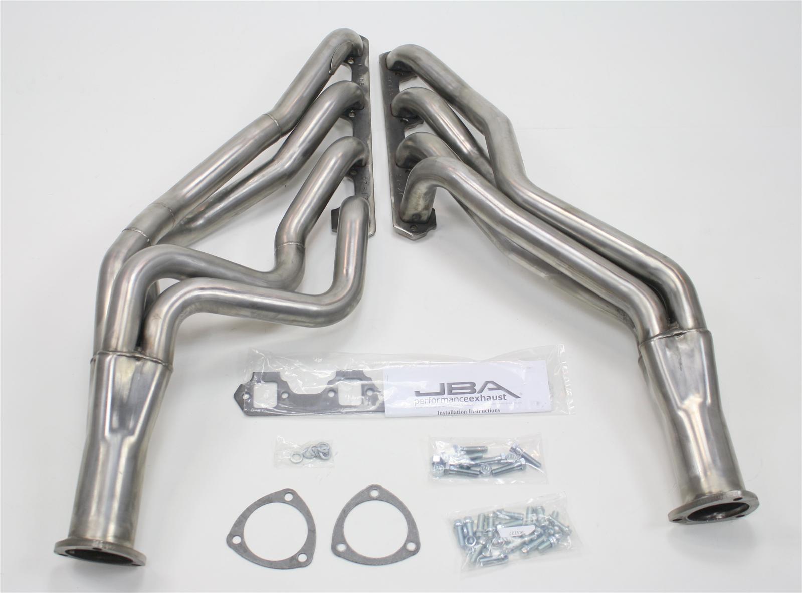

As for headers...I've always put long tube headers on as I believe they give better performance than shorties....in some cases shorty headers do very little to increase HP/TQ over OE manifolds. Remember that smaller headers are better than larger diameter.....I would say that 1-5/8" or no more than 1-3/4" headers would work great...yes, 2.5" tail pipes with an H or X will work great.

New subject on my project:
I face a problem with my clutch.
Problem was already existing but got even worse with the Borgeson Z-bar:
The lower part of the clutch linkage is permanently in contact with the header (except when I disengage the clutch).
it works, I'm using the car, but I don't like the fact of this contact and I dont like where it puts the slipping point at the pedal (too far, almost all the way down).
So I now see 3 options:
- cut and weld my Z-bar to change the angle and make it clear the exhaust
- go for a cable conversion
- buy other headers.
The exhaust that is actualy on my car is a classical 3Y (4-2-1) all rusted. I don't know what make it is but it looks really similar to the cheap Scott Drake one which has 1 1/2 primarys, 1 3/4 secondarys and 2 1/2 final.
I believe that this exhaust will be too small for the stoker I would like to build, so maybe my clutch problem can be the right oportunity to find a better one.
What d'you guys think?

Your current Tri-Y headers are limited to about 4500 rpm....Tri-Y's are not a real performance header.
Long tube headers are what would work best on the 347 stroker and my recommendation would be a stepped header with 1-5/8" primary tube with 1-/34" secondary tubes.
My recommendation is none of the above, I would be to take a ball peen hammer to the tube that is in the way........even if you dent it in 1/4" or so it's not going to really degrade the performance that much.
A good set of headers will not be cheap and probably not hook up the the rest of the exhaust system and will require you make a trip to your local exhaust shop.
Just go the cheapest was since it's your daily driver....that's what I would do.

I've seen a Youtube video with David Frieburger (from RoadKill) where they do tests on a dyno destroying headers and looking how it influences power drop on the Dyno... And they are amazed to see how hudge dents don't affect at all the curve!
:-p
Olleroder, what exhaust do you have in mind?
I've seen one from JBA that is 1 3/4 and goes to one 3"... apparently specialy designed for Borgeson conversion, but pricy.
I know that it won't bolt on and will need mods on the rest of the line.
time to switch my 2" to 2,5" ?

Yes, usually dents won't make a huge difference on a street motor....on a race motor with very high lift and a lot of overlap a huge dent will usually make a cylinder go lean.........not a good condition to be in when pumping 14 or 15:1 compression on 114 race gas.
Usually I make my own headers or have them make at SPD in Sacramento, CA.
From experience with SBF's I would say a stepped header that starts at 1-5/8" and goes to 1-3/4" then into a merge collector that is between 12 to 14" long with a 3" diameter would be best...primary lengths of the pipes really depends on the cam you use. Yes, 2.5 pipes with an X or H and some good mufflers like Magnaflow would be the best...........I also dislike the pipes turning down before the axle.....I like pipes than come out the back and turn down much like the early Mustang non-GT's.
Yes, a good set of headers like Hooker, Headman or Dougs will cost upwards of $500.....you only get what you pay for.............

Didn't have time last night to dent it, but I had time to look a bit to pipes available on the market.
@ Olerodder : I found only one exhaust stepped 1-5/8 to 1-3/4... It's a Husler race ultimate for mid to high rpm at 850$ !
I don't think I'll go for that much money.
If not stepped, what diameter would be good?
Should I look to ceramic or would a painted one would be enough?
how long will last a painted exhaust?
Fxxx the plastic / save the classic

Yes, good headers are not cheap....too bad you don't live closer as we could make a set over a weekend.
I would look for 1-3/4" long tube and look for the header manufacturer to talk about merge collector with a collector cone inside where all of the pipes come together.
Ceramic is good as it reduces the under hood heat....with that said most of the ceramic coating you get when you buy off the shelf headers is extremely thin and really the headers should be coated on the inside also....and this is only done when you take a bare set of headers to a good coater...also you need to maintain the ceramic coating...anytime you touch the coating it will leave finger prints and these need to be cleaned before firing the motor.
Get the headers, use VHT header paint in the color of you choice, follow the directions and redo them once every year or so....remember...it's only paint.
If you were to get Stainless Steel headers you would never have to worry about painting.
First picture shows the cone inside the merge collector, second shows the 13 degree merge of the pipes into 3-1/2 collector and the third shows the headers on my Maverick drag car....just by changing the collector I brought the torque down on the motor from peak of 540lbft at 5900rmp to 544lbft at 5700rpm.

So if no stepped, 1-3/4 will be good?

What would you think of this kind of stuff (Summit):
1966 FORD MUSTANG JBA Headers Competition-Ready Headers 6610S
Yes, they look good....make sure they will fit whatever head you're going to decide to go with..........hate to spend this kind of money only to find out they won't fit an aftermarket head.
