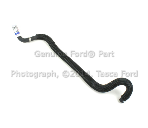

Strangely that is not the hose that runs to the thermostat housing and has the backflow valve.
According to the diagram it is part #BR3Z8075B and looks like this...
I have no idea why the part numbers are mixed up but that has to be the most expensive foot long hose in history. List is $73?
BR3Z-8075-B*RESERVOIR HOSE for 2012 Ford Mustang

Old 05-09-2015, 11:48 AM   #30
ponie1992's Avatar
Location: Lexington
Posts: 1,053
You have the wrong part number according to what was replaced on my car.

I know it is a different part number but here is a another pic of the part they call BR3Z8075B.
It looks identical to the picture you posted. I have no idea why the numbers are different. To confuse us I guess. Notice the backflow valve in the pic.
Probably lol. All I can say is look at the dealer work order picture that I posted. That shows the exact part numbers that were put on my car for this issue.
That's definitely not the part on the OP's car, though. Notice the braided sleeve in your pic that's not in the OP's pic.
I should check to see if my car has the "upgraded" hose...don't need a water pump crapout!
