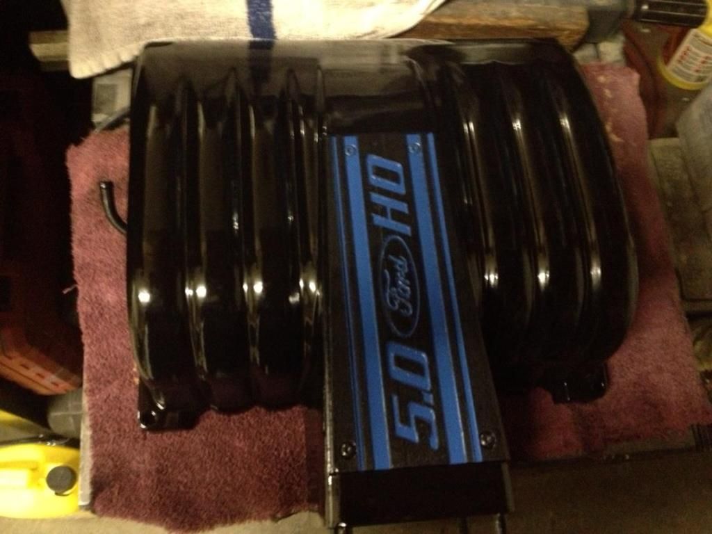

Thanks just got my upper intake painted running the wires is the biggest pain
