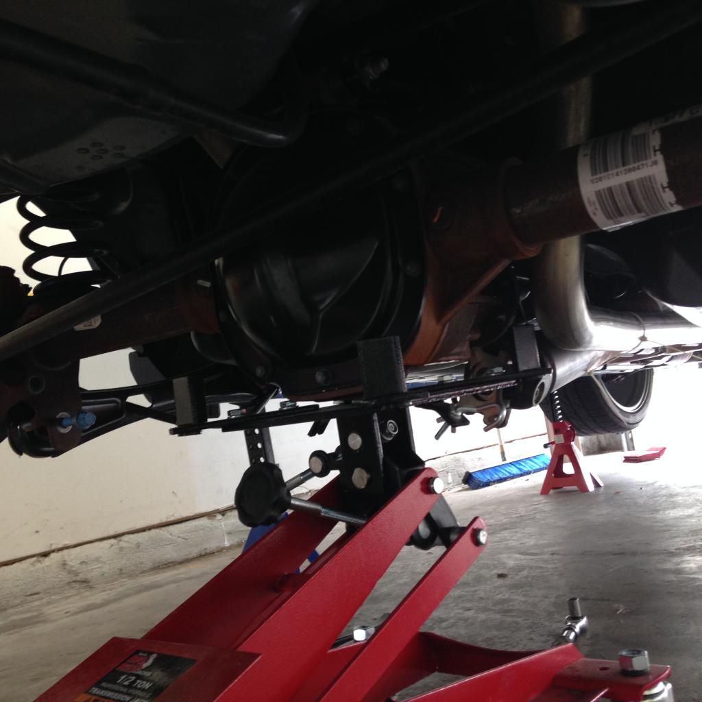

So, we got the rears swapped today, and below i'll make sort of a short walkthrough / step by step and try to list the steps needed.
First, I decided it would be best to remove the driveshaft to prevent it from binding as the axle starting shifting from removing the various pieces. There's 4 bolts on the shaft, 12 pt 12mm socket and they come right off. I just zip tied it against the exhaust to keep it from drooping down, but it wasn't really in the way.
Next, I figured the sway bar was in the way of a lot of the LCA / PHB bolts so it would be best to take that off next. Took the 4 nuts off the umm axle, strut, piece.
And next you take the 2 holding the end link off the body. Easy enough.
So, I got the LCA bolt about this far out before I realized the axle was binding it quite a bit
So I figured it was time to bust out the handy dandy trans jack and put it to work.
This baby pivots on an X and Y axis, making it extremely versatile and useful in situations like this.
Up next was removing the rear calipers / rotors. The Difficult part was that everything I could have possibly zip tied them to was being removed... so I just assembled whatever boxes I had laying around to get the job done.
Important safety tip, don't forget this hal effect sensor when taking everything out. I believe its the traction control since its measuring off the hub, but whatever, take it off.
So, lastly was the 2 bolts holding the struts on the axle, and the PHB, but I needed my GF to come out for a spare set of hands and didn't get pictures of the process. This, ladies in gentlemen though, is how you get an axle out. Granted we have done a few sets of LCAs / brackets / PHB now, so we were used to the process. Having an impact also makes the process go by faster, but it probably wasn't even 1 -1.5 hours before we had it out.
Important safety tip. The axle is heavy as hell, i'd guess about 200 lbs or more. It is very important to have a confident hold on it when moving it about.
First, I decided it would be best to remove the driveshaft first to prevent it from binding as the axle starting shifting from removing the various pieces. There's 4 bolts on the shaft, 12 pt 12mm socket and they come right off. I just zip tied it against the exhaust to keep it from drooping down, but it wasn't really in the way.
Up next was removing the rear calipers / rotors. The Difficult part was that everything I could have possibly zip tied them to was behind removed... so I just assembled whatever boxes I had laying around to get the job done.
