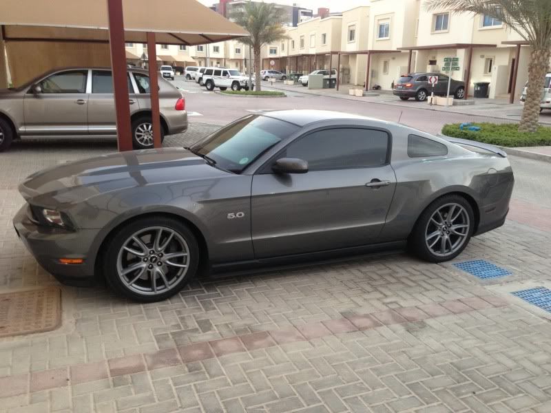

On my factory Brembo 19x9" wheels, I'm running 275/35-19 front and 285/35-19 rear tires. No clearance issues or increase in bumpsteer, despite what some people claimed I would experience. Sits perfect, and my overall traction for launching and handling is GREATLY improved!
You mind posting pictures?
Sure, here are some I just went outside & snapped with my iphone...
